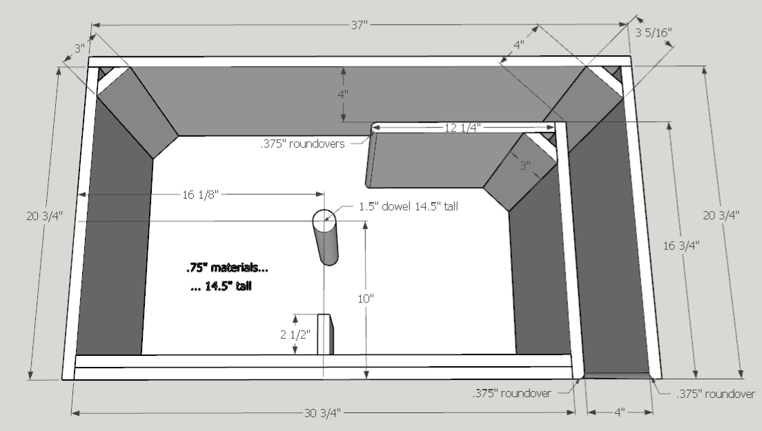

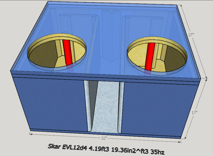

Tell you what... provide useable dimensions and ill do up a nice 31hz design for your power but leave room to strap those RP's at 2ohm if you want to really flex them someday.
I MIGHT be able to come-up with something...
You.got tools and a router?.. id like to do something decent.
What about 37w 16h 18 d
Well it MIGHT be doable in that space with an aero and smallish volume but I wouldn't design something like that... "ugh!"... I'm sorry man... a slot with your power and tune just ain't gonna work in that space (Sub displacement, double baffle, port volume and bracing adds-up) those subs need some volume and some port area.. oh I can do something if you find more space... what's the deal?.. I thought you had a good sized trunk?.. take the bodies out and make room. Those subs LOVE a decent sized box with a lotta port.
I do have experience with those exact subs btw...
I'm saying width, depth or height... something's gotta give
Even if I single-ply the thing, leave out bracing and port it for 2K only you gotta find some space.
Just what to cut each piece. Yea I think that's gonna make it bubble lol

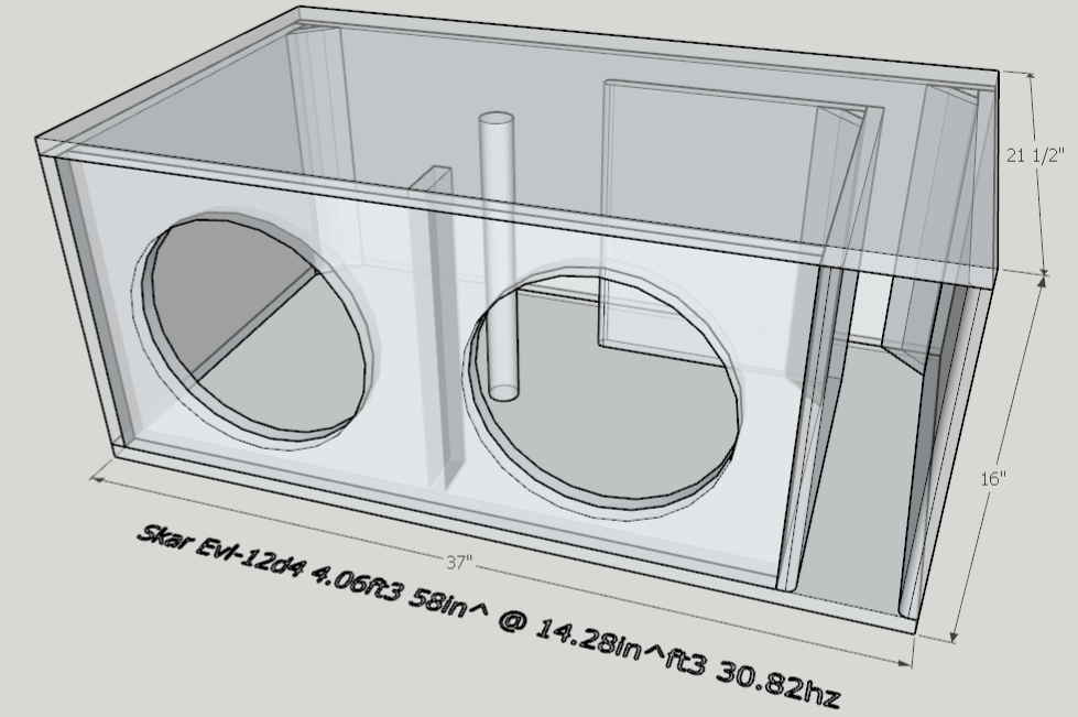

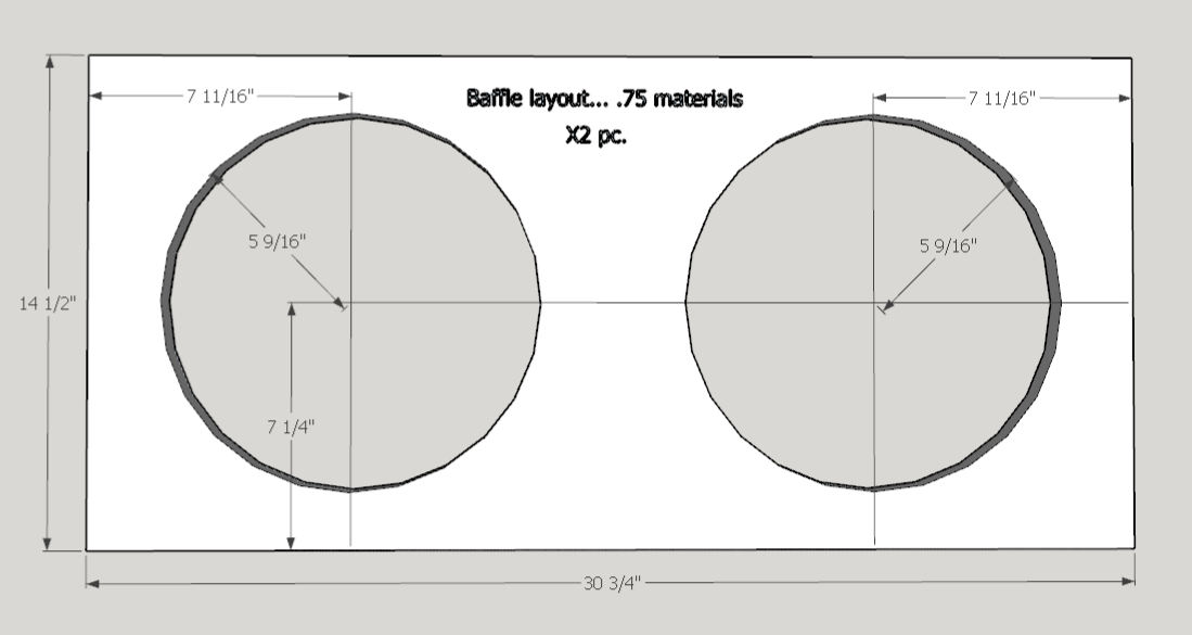

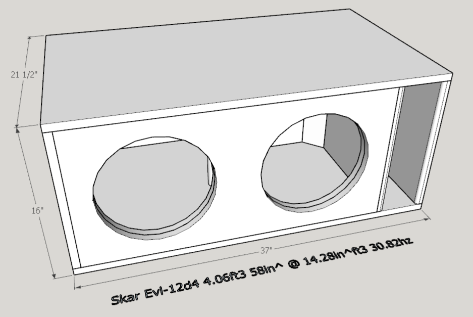

Think you can work off this?
I thought you'd find that more useful than a "cut sheet"
I left the height & width but had to change the depth a bit... but that ^^^^ should get low and do well.
