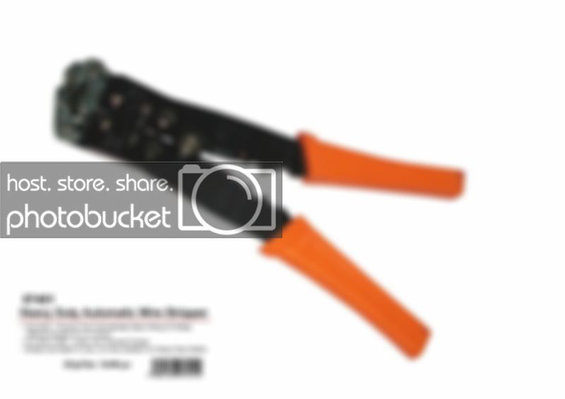

I solder everything. Peace of mind, but sometimes you just cant solder wires because of location so I use these:
with these:

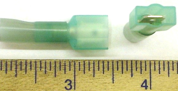

If you are using t-taps, the first picture, you can just strip a small portion of the jacket back and clamp the t-tap on the wire with pliers. Than use the male spade, second pic and plug it into the t-tap after you have crimped the spade on the wire you are adding into the circuit.
