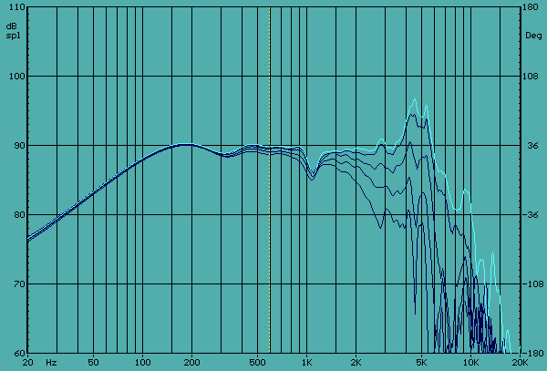

This is how they sound. You'll need to tame that break-up between 4.5-7k with a notch filter and address the depression around 1200Hz with some EQ before applying a crossover filter but it should sound nice overall.
