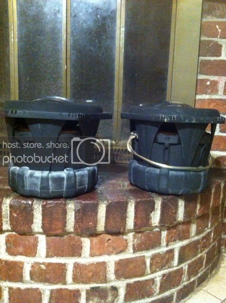

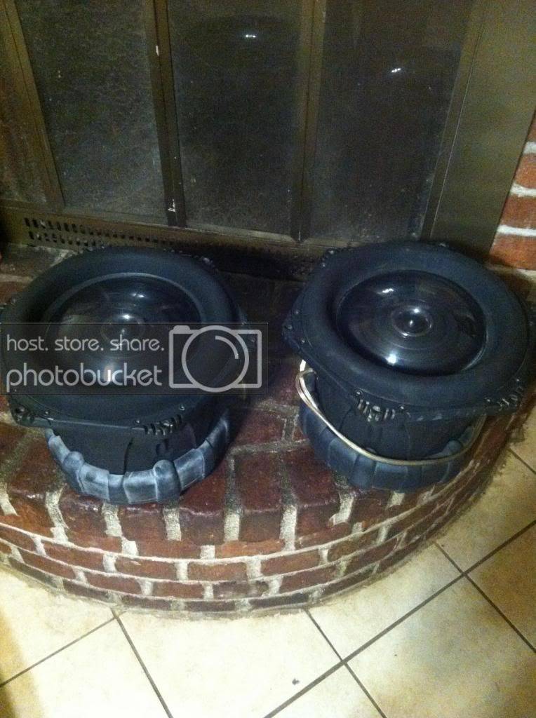

Think I can do 150db on music not burp off 5-6k? Car is 03 Nissan xterra, mean green 200a alt, kinetic hc1800& pair c&d 147ah batteries..multiple 0g runs..only have about 5.5 cubes for enclosure as I don't want to block my view through back window..subs either be pair 12" cerwin vega stroker pro or single 15" rd superheavyweight..amps are going to be pair diablo proto 2500
going to be tough on music....I say no on the single 15 doing it, maybe on the 2 12's
also depends on the mic location
Think sub and port going up would be best? Hatch an box would be very close to each other..also u think I can do 150 burps? Thanks in advance
150 on burps shouldn't be a proble, but too many variables to tell
sub up and port back is the best if you can fit it
i would do the strokers, and i say it can be done //content.invisioncic.com/y282845/emoticons/thumbsup.gif.3287b36ca96645a13a43aff531f37f02.gif
For burp I'd use the heavyweight and tune high, for music the strokers any day of the week.... those are just **** as hell and 2 coils will take the power a lot better.
I'd advise you ditch those amps and get something reliable though.... they are time bombs.
i think he can get the 150 on music. thats what im aiming for. if my bc3500 wasnt messed up i think id be there. or VERY close. im thinking it was a 150 tho when i hooked it it up
definitely try out the 12's. You never see anybody running the strokers so it would have the cool factor on their side. Also, subs up and port to the side is sometimes louder in SUV's. I think 150's with music are definitely doable with the 2 12's with that power.
Got a guy on my team with 2 15" lvl5's off an NS1 that does 50+ playing music and 53 burp. Sealed scores in a TB, peaks around 36Hz.
I'd go for the 2 12's as you'll want motor strength/coils to spread the power assuming you mean playing music at 150...
