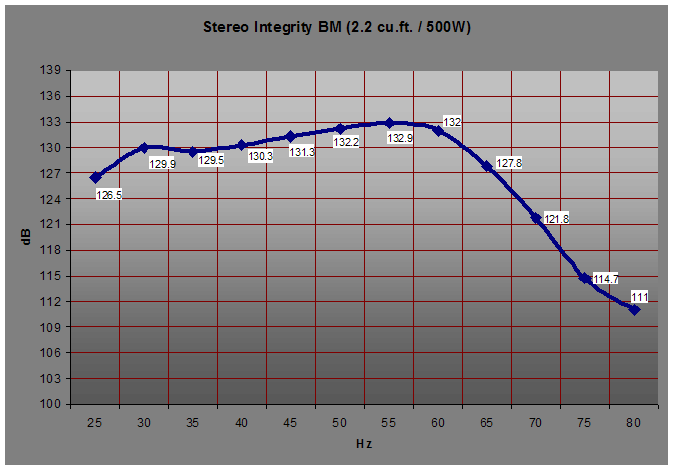

I'm a huge fan of them as daily driving woofers that sound GREAT ported. Just for Jim... SQL SQL SQL!!!
oh, you're just being mean...
//content.invisioncic.com/y282845/emoticons/biggrin.gif.d71a5d36fcbab170f2364c9f2e3946cb.gif
The BM's are definitely cool little moofers //content.invisioncic.com/y282845/emoticons/smile.gif.1ebc41e1811405b213edfc4622c41e27.gif
The BMs are very strong little woofers... I'm a huge fan of them as daily driving woofers that sound GREAT ported. Just for Jim... SQL SQL SQL!!!

I will say this about the BM... for a daily sub in a vented enclosure it *really* give my all time favorite daily sub, the SI Mag, a serious run for it's money if you don't take absolute output potential into account. I did a setup for a friend with 2x 10" BMs vented with an SAX-100.2 to power the pair... and it really suprised me, EASILY outpacing my sealed Mag D2 12" with an SAZ-1500D in output. If I had to choose which one I prefer vented, sound wise, I may even lean towards the BM. Of course... the Mag is king sealed, IMHO //content.invisioncic.com/y282845/emoticons/smile.gif.1ebc41e1811405b213edfc4622c41e27.gif

It's not entirely a fair comparison. It was a *single* Mag D2 sealed with 1500 watts vs. a pair of 10" BMs vented with 200 watts each -- the SAX-100.2 was bridged to a 4 ohm load for the pair.
The dual 10" BM system works GREAT with a factory electrical system in a Lancer with a Wal-Mart wiring kit... my sealed 12" D2, on the other hand, melted the fuse holder from that same kit with a 12" long power wire (rear battery install) *laughs*
I would take the BMs in a vented box any day for a lower powered system, they are SO efficient.
