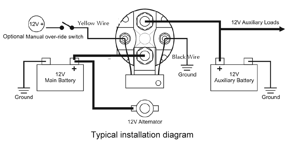

If I were to add an extra battery it would be an isolated setup. So, the main/starting battery is isolated from the aux/audio battery during cranking and vehicle off. RV type setup. This should suffice I would think with the addition of the second HDS312/Q-1200D added in the near future.

What size high output alternator should I be looking for with the setup in my signature? Running main group 78 AGM battery and secondary group 34 AGM.
Big.
I'd probably start with 200A and see what's available. Sometimes it's not much more expensive to go to 220 or 250. The bigger the better.
