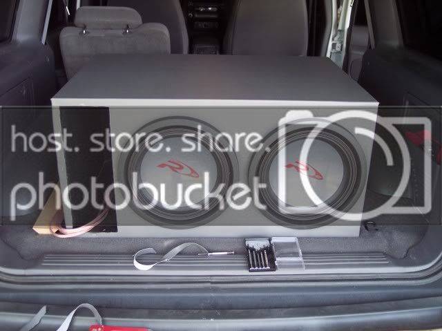

i got 2 1222d 2ohm type r 12's and a mrp-1000 alpine amp... I listen to hip hop... I bought in a sealed box, i need a ported box, will have made custom, I wanna know what box will be best, cu/ft, hz, ports/ port size ect.... alpine recomands .75 to 2.0 per sub, i heard 2.2 per sub was "sweet spot", via this forum.... if you guys can help me spec the box, ill stfu and leave u all alone, god bless.... I JUST WANNA MAKE SURE MY BOX IS A-1.

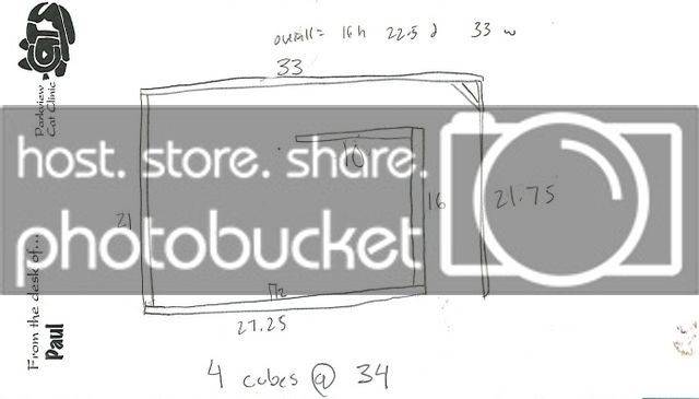

Here:
Its proven to work many times. If i remember the corner piece is 3''.
I would do 2.5 cubes each , with the tuning around 35hz and about 70-80 sq inches of port area. Subs facing up and single port in the middle facing back . can't really go wrong with that box. will surely beat your sealed box lol
