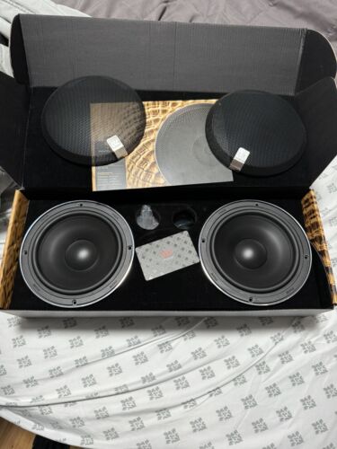

Replacing my mid bass in my 04 Silverado crew cab and looking for recommendations in $300 range. 2 standouts for me are Stereo Integrity TM65 and DD Audio AW-6.5A. I like that they can go down to 65hz and 50hz respectively. Doors and cab of the truck are fully sound dampened. Amp is AudioControl D4.800 4x125w rms. I am open to other recommendations in this price range as well. Stereo Integrity is $399 regular price but they do have $100 off sales at times.
Yep ordered a set myself and I was planning on the dd a series since I love their ceramic dome tweeters
