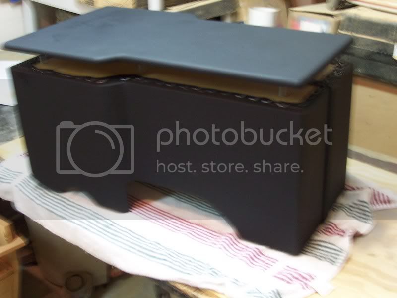

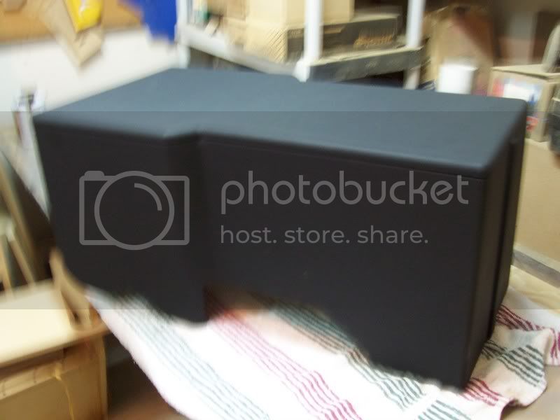

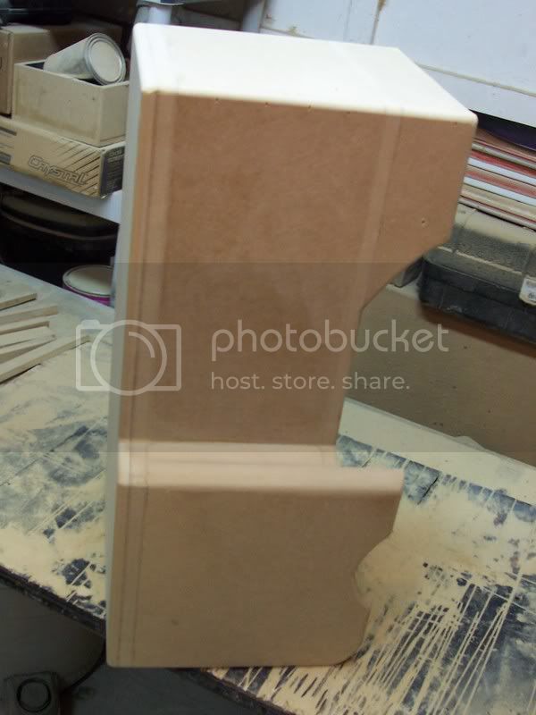

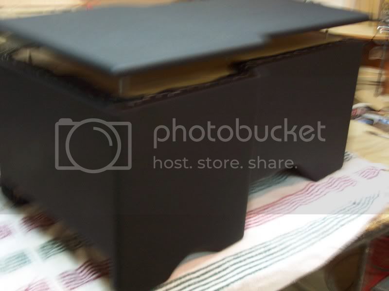

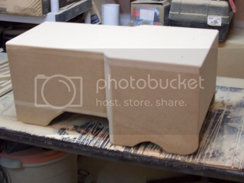

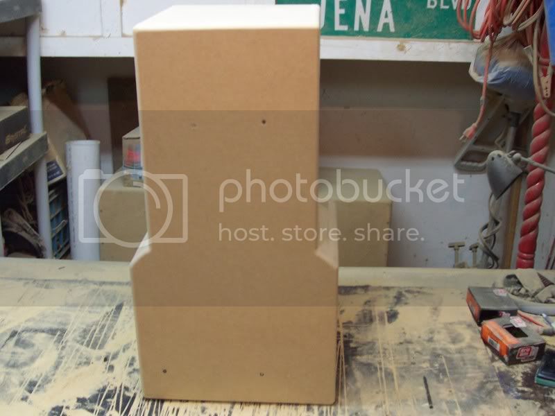

Ok the project is to remian stealth but get loud!

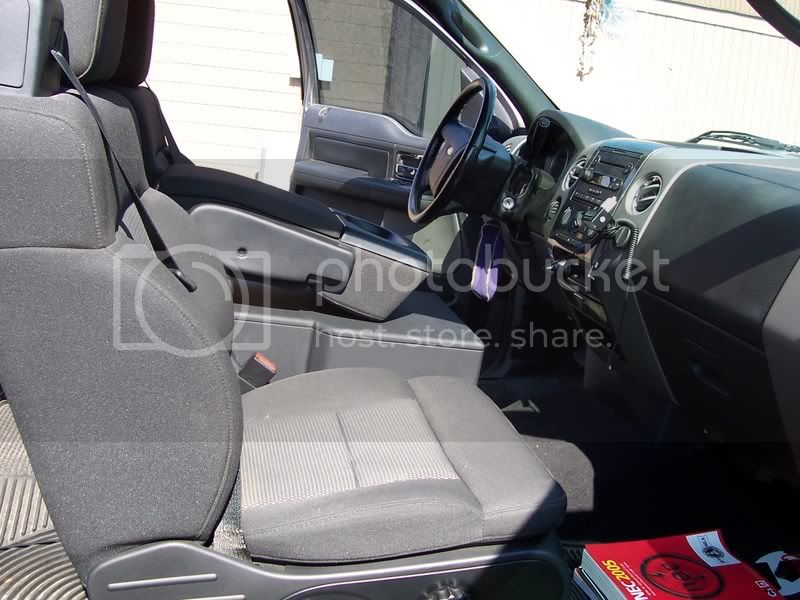

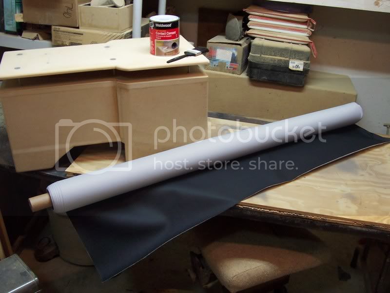

These trucks **** for under the seat room so the best bet is to go the the console with the enclosure....so i did......It is fairly easy to get 1.5 cubes and still remain at a resonable height and does remian comfortable.
I did not take alot of early pics....I had bateries charging and could not slow down so I started taking picks about half way through......sorry. //content.invisioncic.com/y282845/emoticons/frown.gif.a3531fa0534503350665a1e957861287.gif
objective:

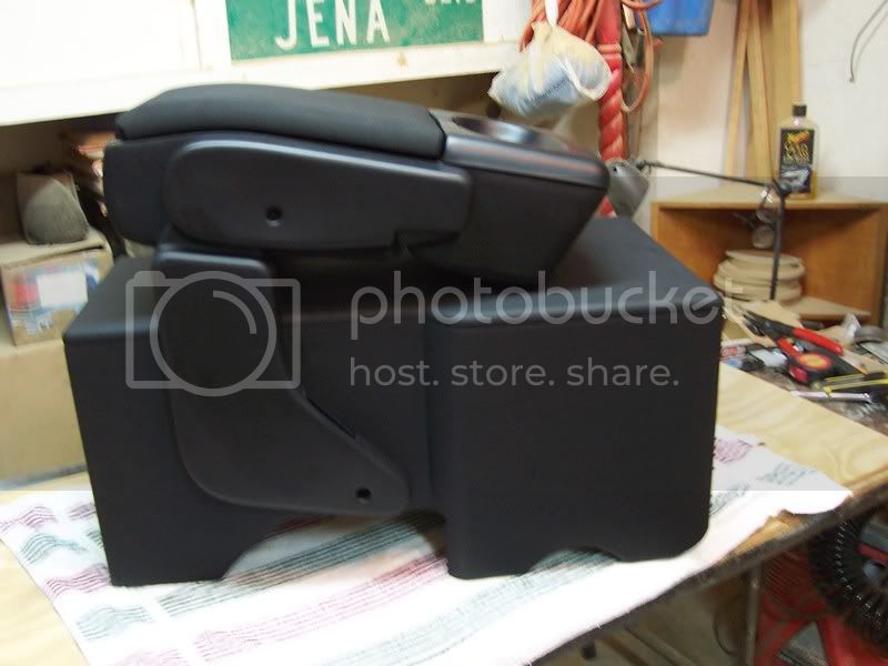

Keep stock arm covers
keep stock top arm/storage area.

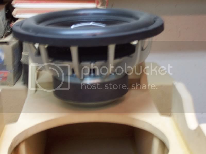

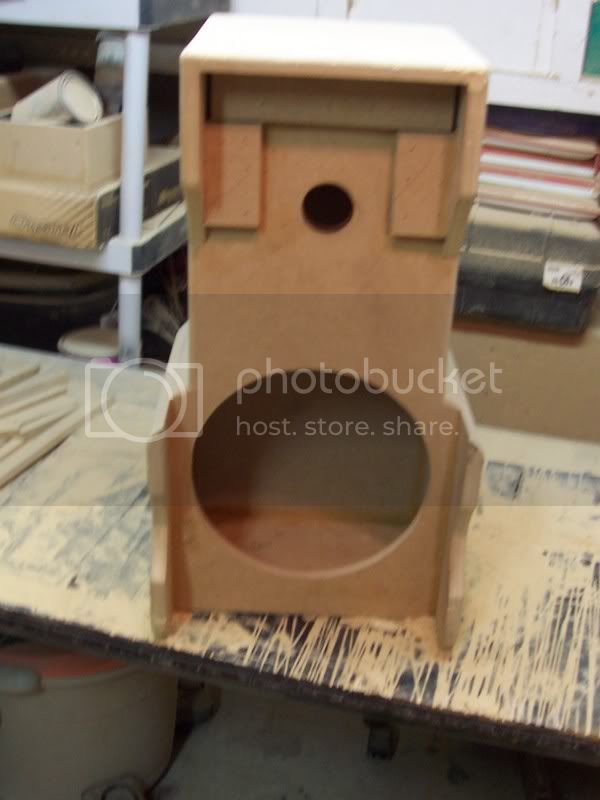

Woofer being used is a Fi 12" SSD
the rest of the system is still uninstalled...I dont have the time to run wires and install the HU so a local shop willl cover this fun activity.

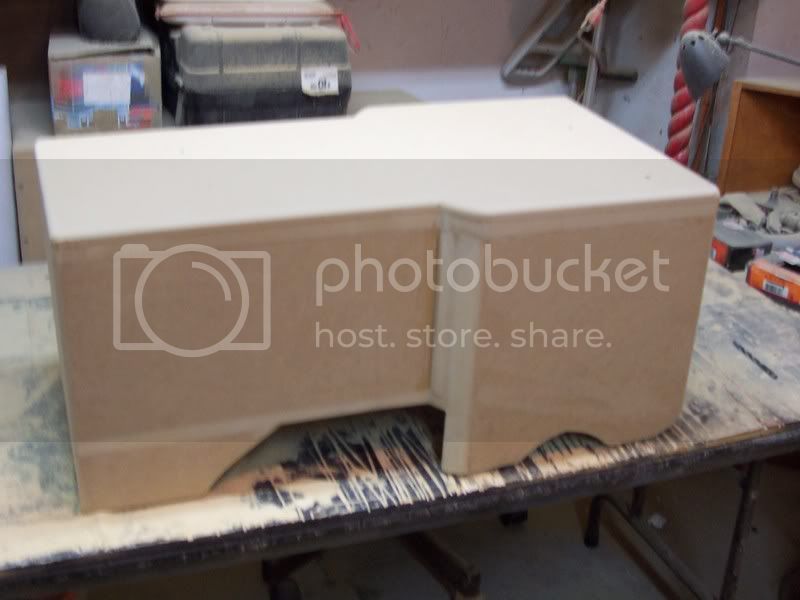

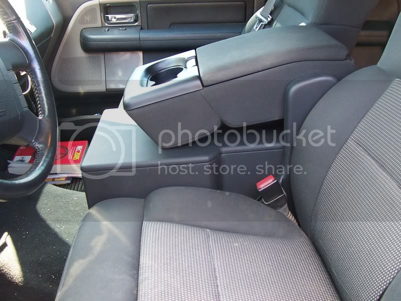

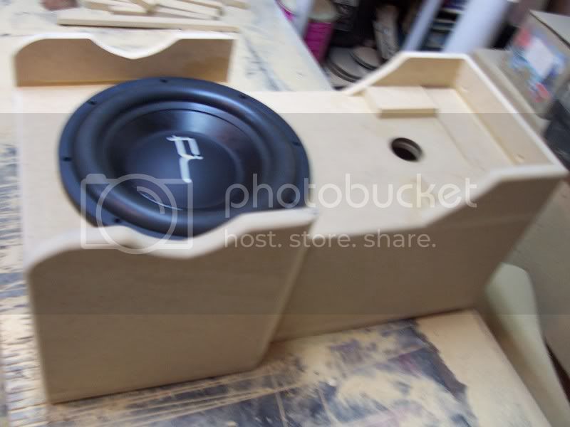

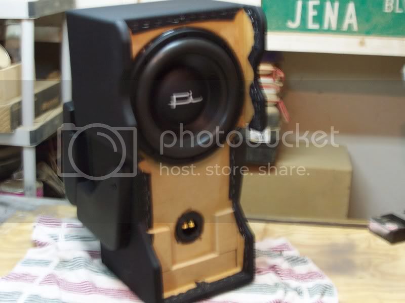

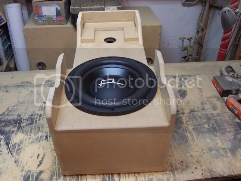

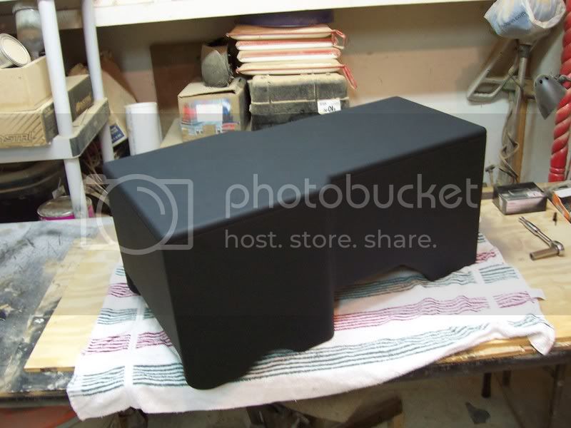

So I drew out a working sketch....made my cut sheet, made the cuts and started peicing together......and that gets us here.

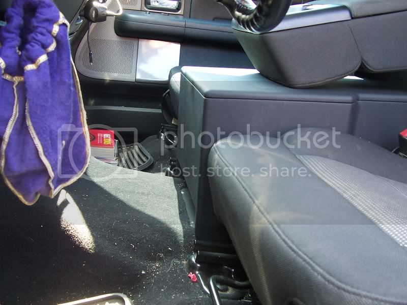

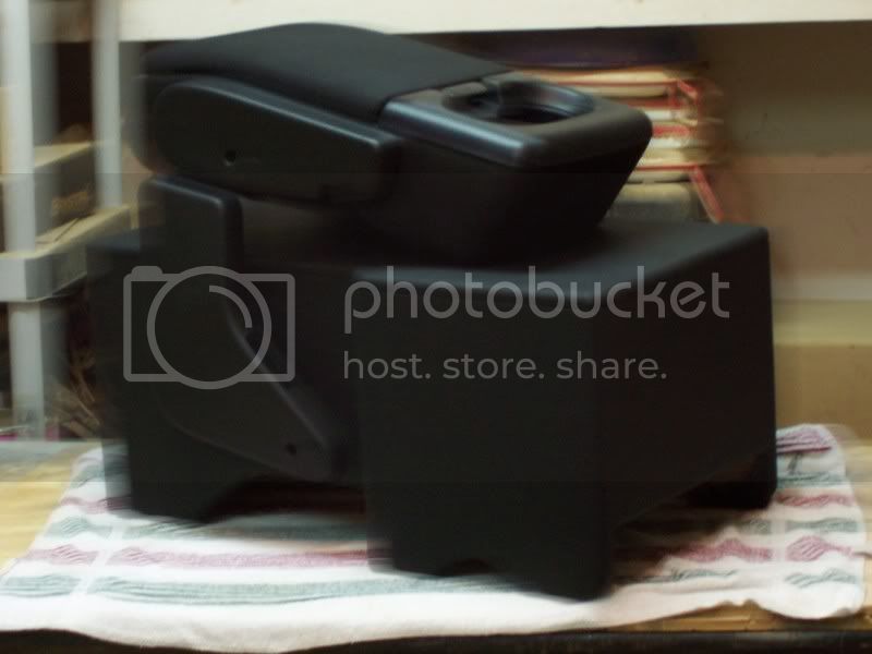

test fit woofer and check clearence....we have 3" of clearence so I think we are good.

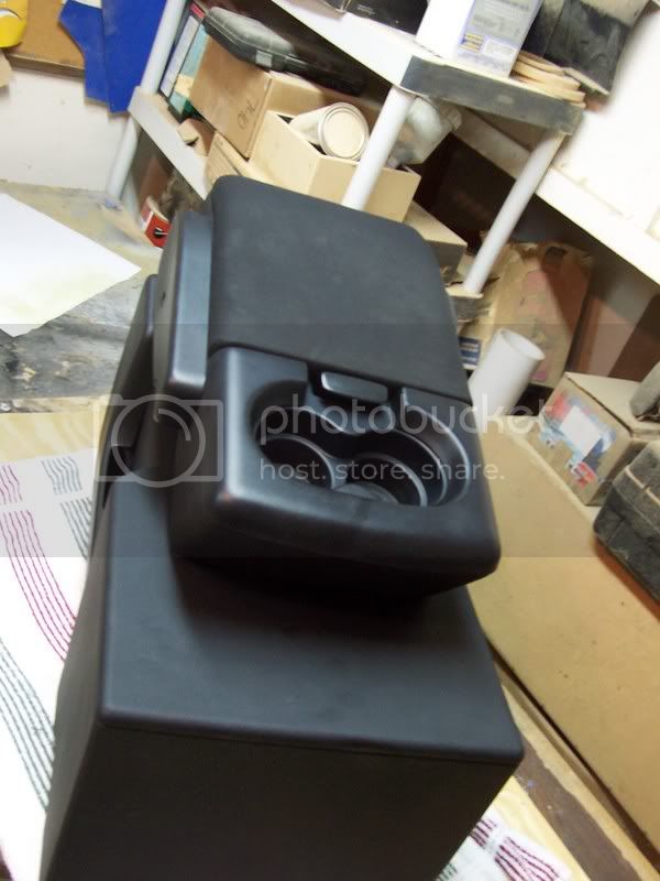

I like it and owning a supercrew myself (02) I feel your pain in the sub department.
I wish I had bucket seats to make a center consol like that.
I love how that looks, except for the top portion with the cup holders at the angle.
Personally I would get rid of the very top and just **** it up at not having a cup holder and little storage area.
you could just put a little cup holder/storage right in front of the enclosure on the hump. All the crap you put in there will just rattle and drive you crazy anyway. //content.invisioncic.com/y282845/emoticons/smile.gif.1ebc41e1811405b213edfc4622c41e27.gif
