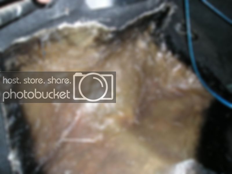

Okay, time for new pics... well a pic..
So this is how it stands now, started trimming down frayed/ crappy edges... still need to do some trimming and lay a couple layers of glass where bubbles had been a problem... The black is my outline, showing where i needed to cut, still have one side to cut, i need the jigsaw for that one... the diegrinder isnt easy to use there...
Does it look okay to you guys? most of it already has 4 layers of glas, with some areas, such as corners with 5 layers, and the bottom floor piece has 5 layers too..
i used a jigsaw on my box to cut it, worked perfectly fine. As for the hot glue, I never had any good experiences with it because it never seemed to hold up the dowels to the ring, anyhow just use hot glue or staples to attached the fleece to the edges, make sure its completely stretched, its one of the most important stages in the process, GL
OKay, i think that to make it ported, im going to need a 6.2" long flared port 3" wide to get it to 35 hz... does that sound right to you guys? Also, can i also use polyfill in this box to make it seem alrger or is that a sealed box only kinda thing...

If you plan on going ported you will need to make the vol of the box larger..
use the port thing on http://www.the12volt.com to find the around about size you need..
You can put a turn in the port tobe if you need to check http://www.partsexpress.com for aeroports & other plastic ports..
You will need to scuff it real well or mount it to MDF
after you find the parts you need & size's you will need try to think out your plan & see if it will work..
Good luck keep us posted..

Yes, i realize i need to make the box bigger, but i think that once i set my ring where i want it, and set up the port, supported by an mdf ring, that the volume will be great enough... shootin for about 2.2 cubes. I figre i can wrap everything and get ready to resin it, but instead, fill ti with packing peanuts and see if i need to make adjustments before i resin the fleece. Sound like a plan to you?
sounds like a plan //content.invisioncic.com/y282845/emoticons/wink.gif.608e3ea05f1a9f98611af0861652f8fb.gif gl 2 u sir, and oh, at this rate, ill be done with bondo and paint b4 u even get to fleecing! haha
