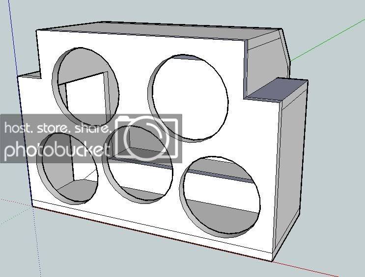

13.5 Cubes at 30hz(daily) and another port for SPL

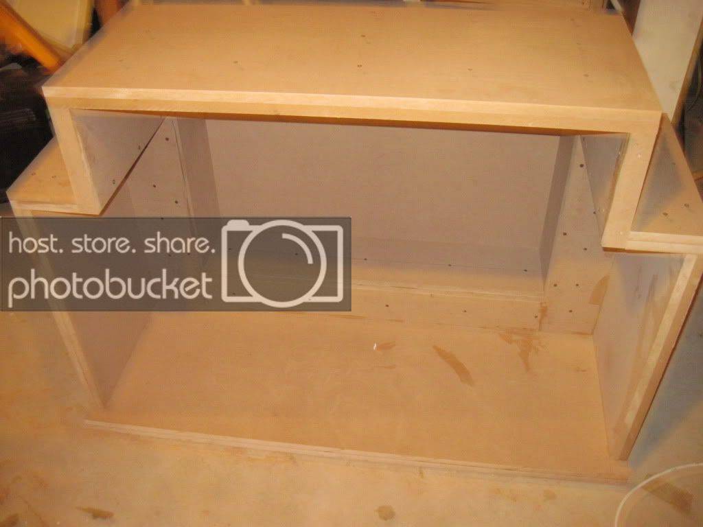

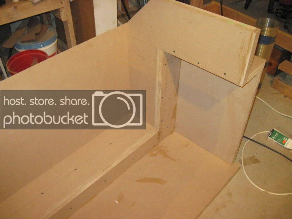

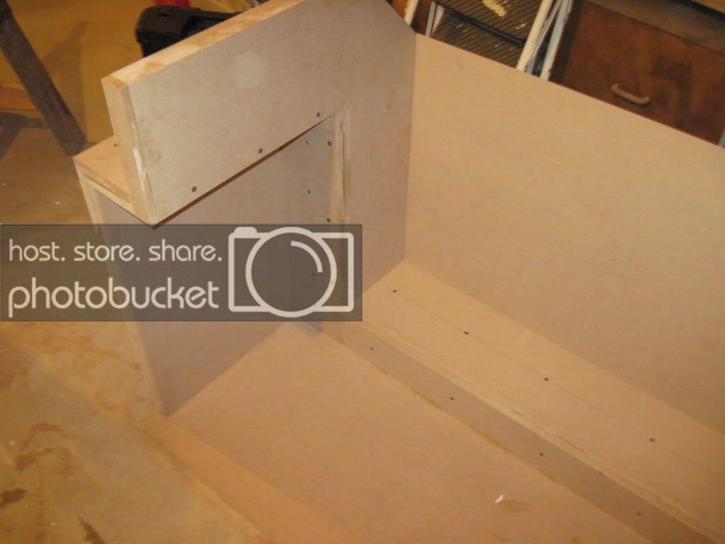

PICS!!! BTW, Only half of it is glued, i just wanted to assemble it to make sure the assembly in-car went easy.
Got the jasper jig and my new router out. The router shorted out //content.invisioncic.com/y282845/emoticons/frown.gif.a3531fa0534503350665a1e957861287.gif. So im going back to lowes and returning it and getting something better.
