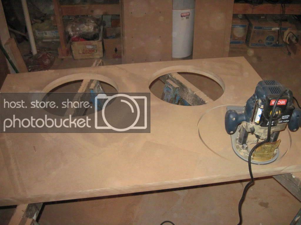

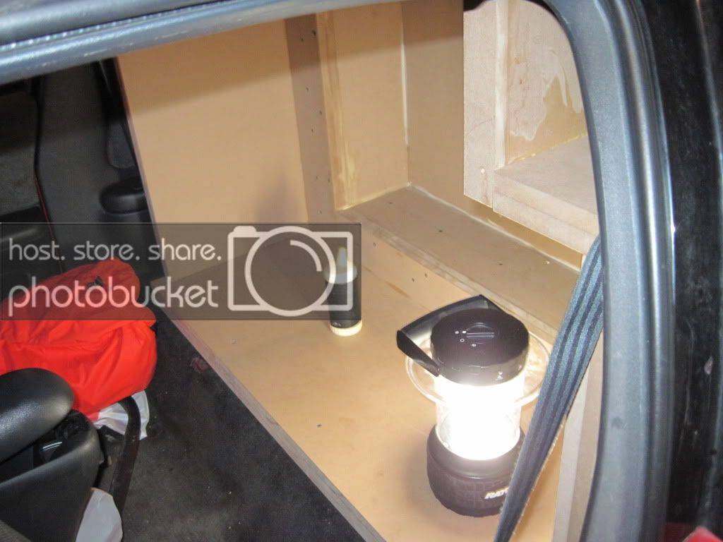

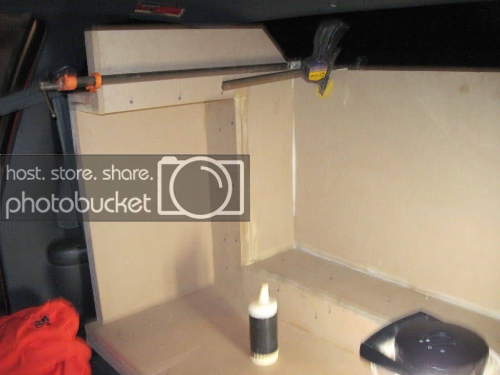

Got my router and my new Freud 1/4 2 flute up carbide bit. Got the baffle done and will hopefully have the wall assembled completely(minus the faceplate) sunday. Then im going to start the door pods for the eminence 10's.

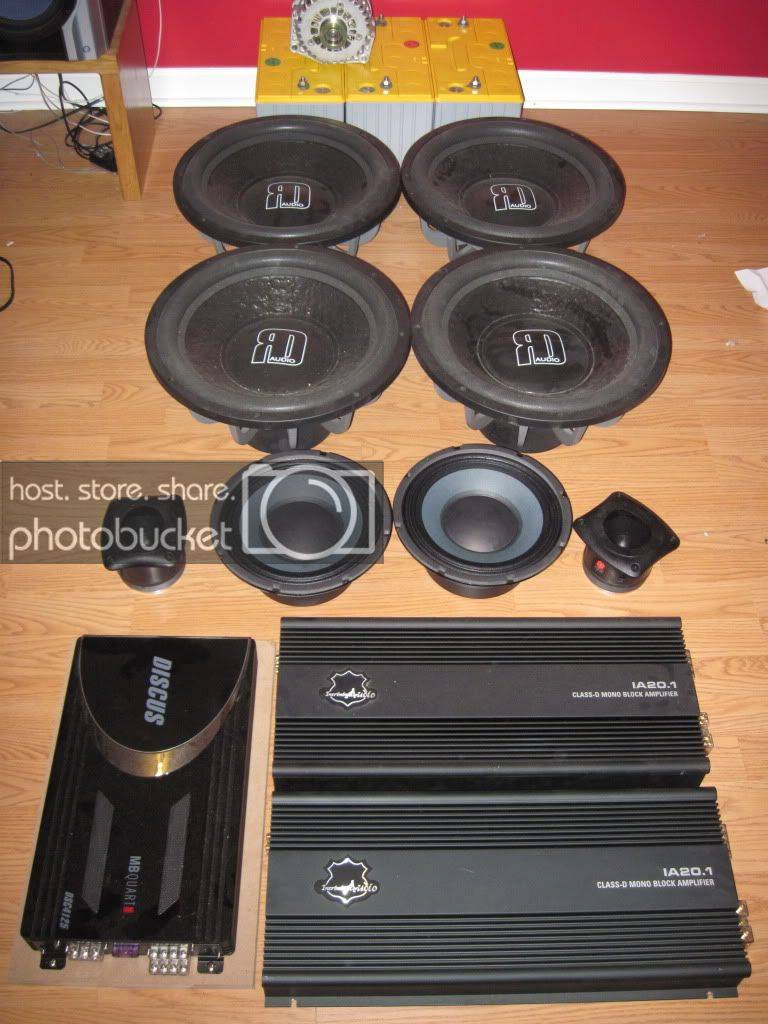

Got all of the equipment in(except the DSC2150, still waiting for it to show)

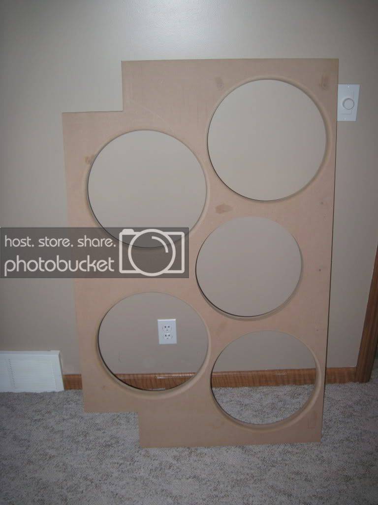

Front baffle is done, got a new router, and i got a freud 1/4" bit and i love it

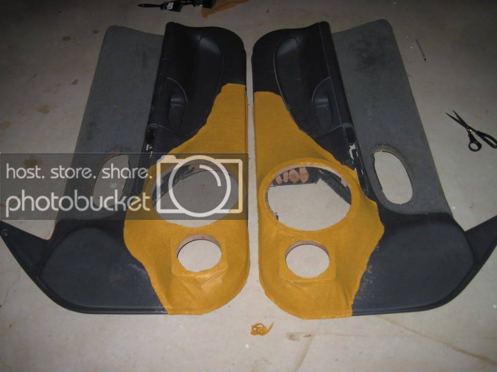

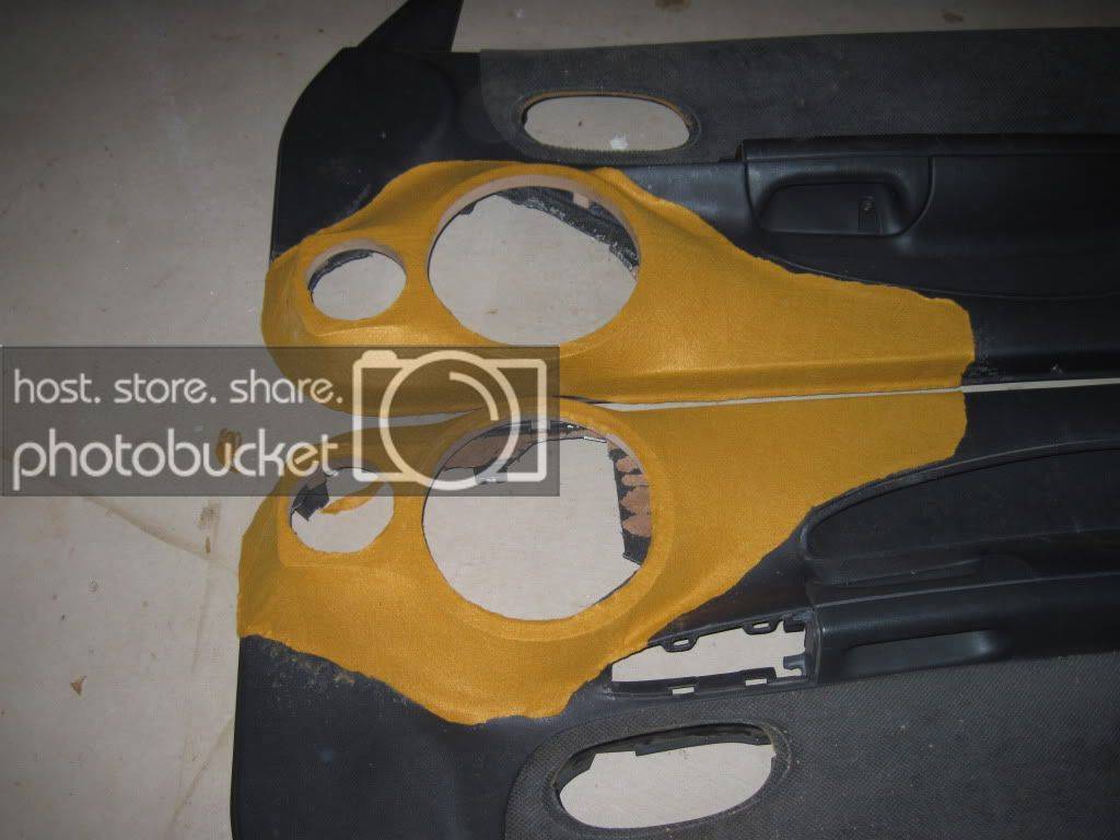

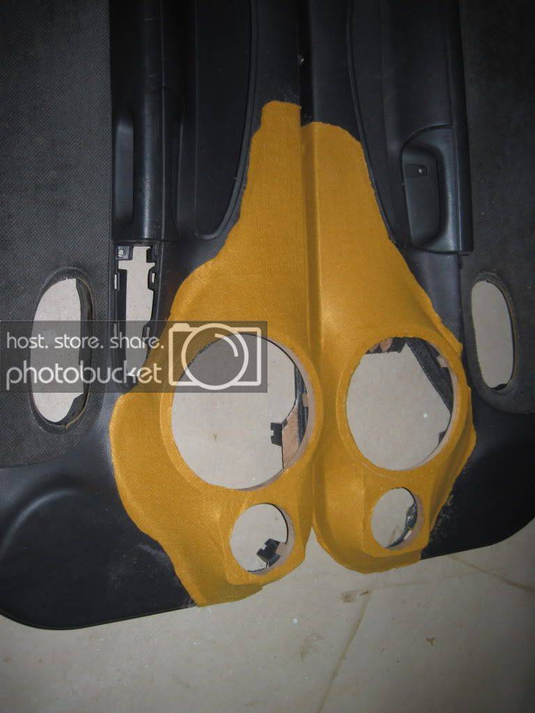

Workin on the bods, fabric is just stretched, need to cover it with resin/fiberglass/bondo/milkshake
Those door look familiar. //content.invisioncic.com/y282845/emoticons/tongue.gif.6130eb82179565f6db8d26d6001dcd24.gif
Haha, yes. You were my inspiration for the speakers. I think im going with paint instead of carpet so i dont copy your whole thing, lol.
Well i ****ed up on the door pods. I used spray adhesive to hold the fleece on instead of CA glue like usual, and it pulled up once it got saturated. Of course this was after i completely saturated the whole thing. Its drying now and im just hoping they turn out ok. If not it was a LOT of wasted resin. Im sticking with the usual T-shirt and CA glue from now on. Works much better than what these forum guys recommend. lol.
