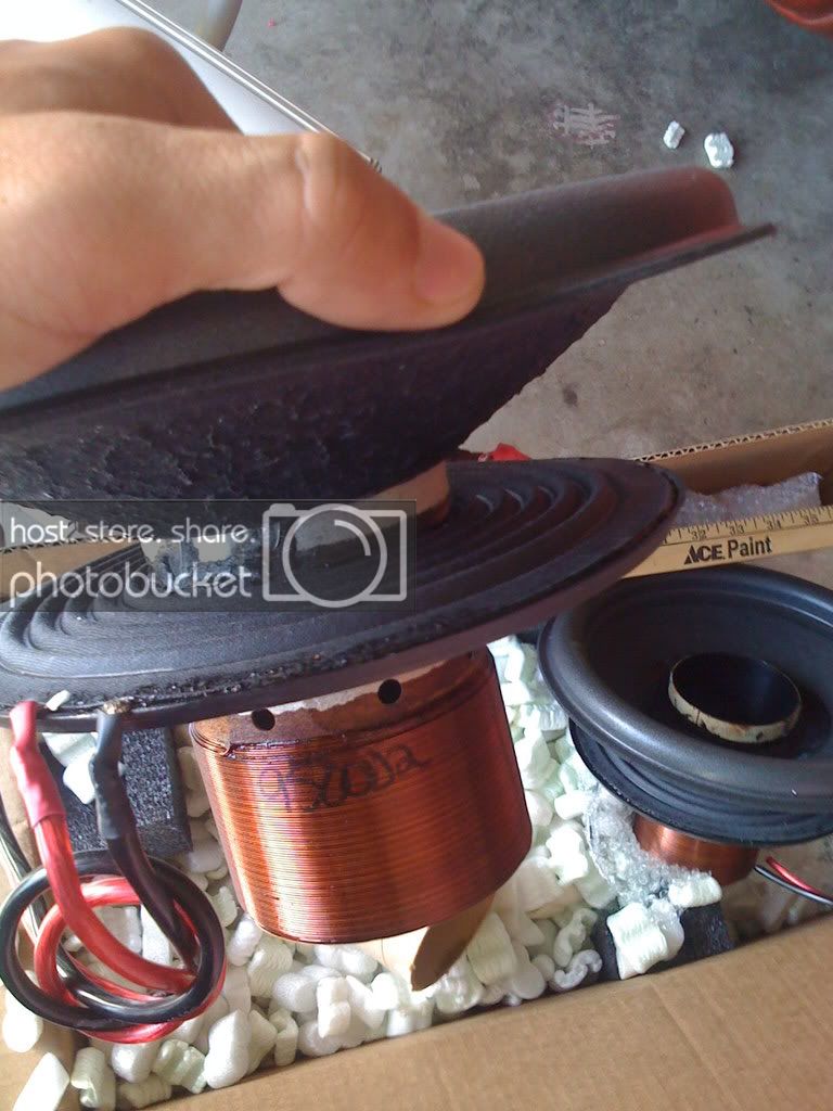

After blowing my first sub, i decided to change things up a bit, so I hope you guys enjoy.
Subs should be reconed within the next day or two, so maybe some some vids by the weekend, but i won't be playing them to hard. Hope you enjoy...

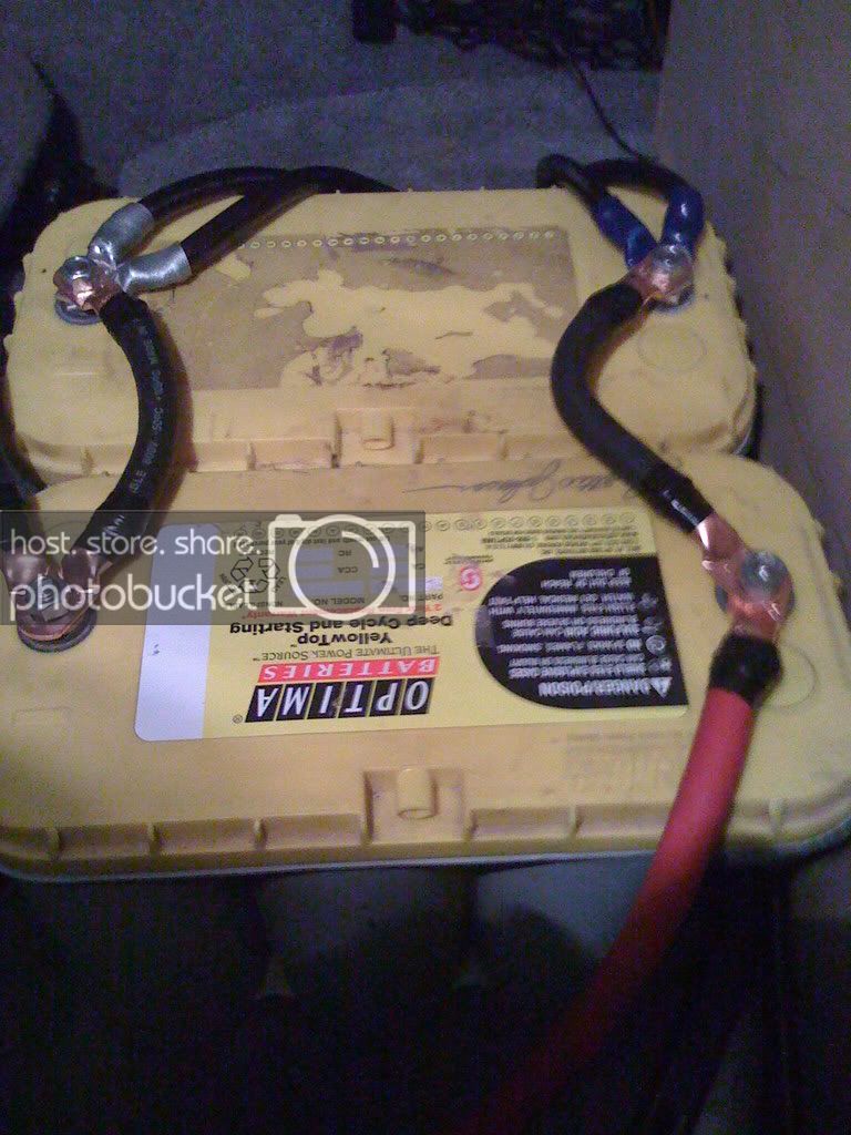

Lots of 2/0 welding cable
Ohio Generator coming in like a week
Optima YT(2)

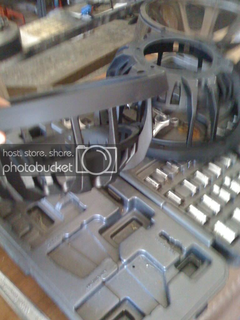

The baskets...

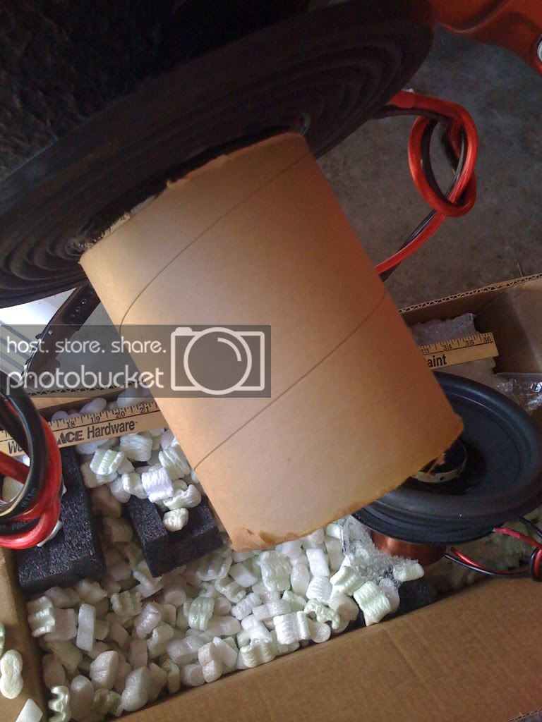

the recones

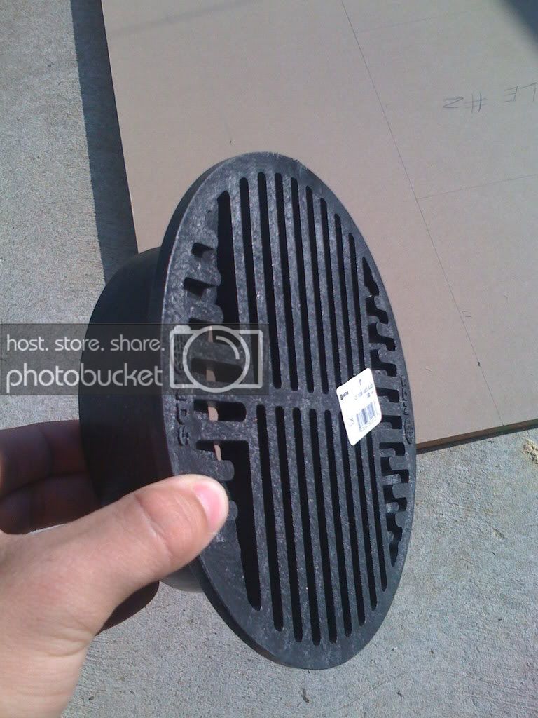

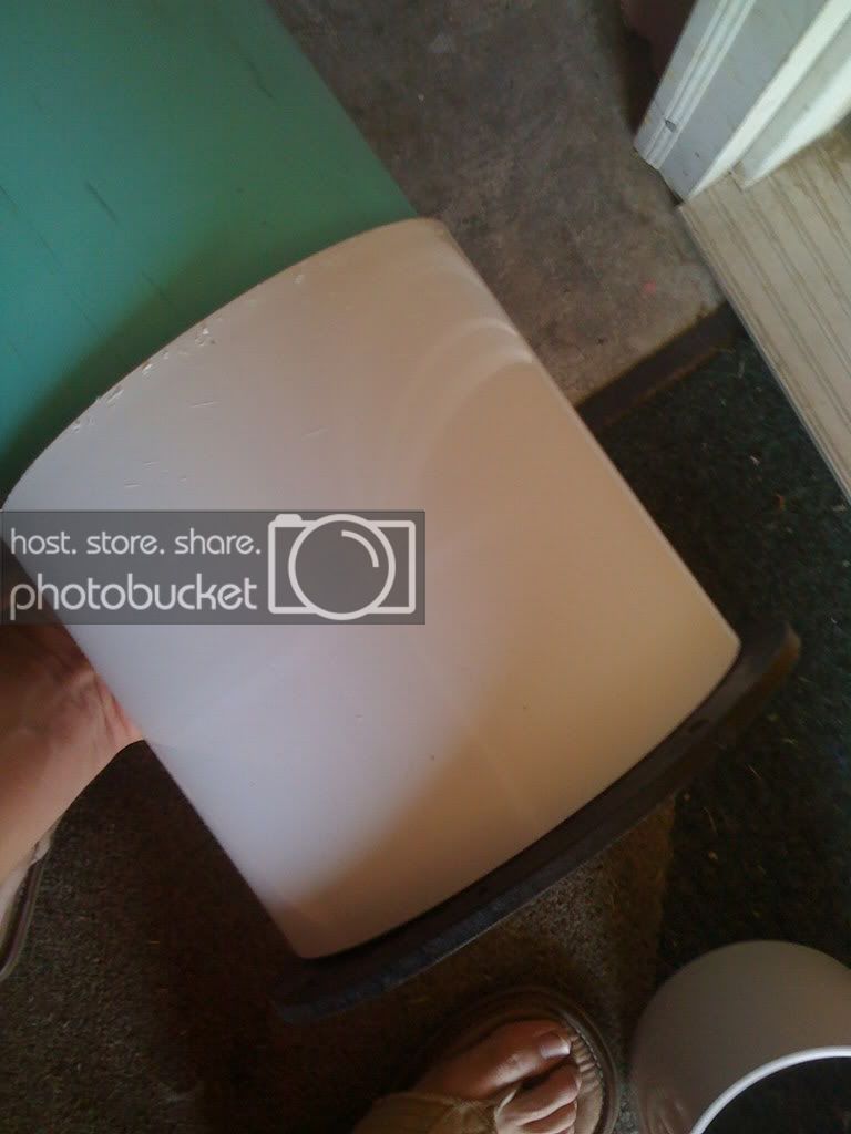

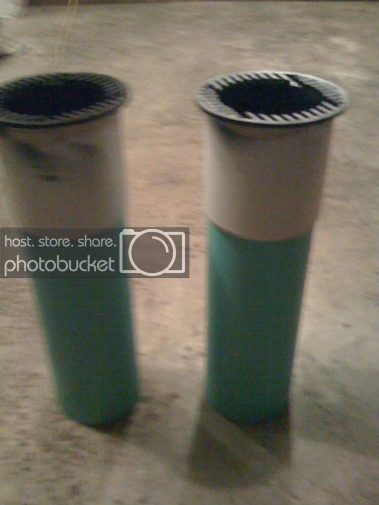

So i thought about how to make a tunable port and decided that PVC pipe would be a lot cheaper and easier to work with. So the black thing is like a grate, i dremeled out the parts interfering with the air movement and i'm using this to screw to the box, i connect that to a piece that connects two 6" pieces, and vuola you have a changeable port.
Got port???

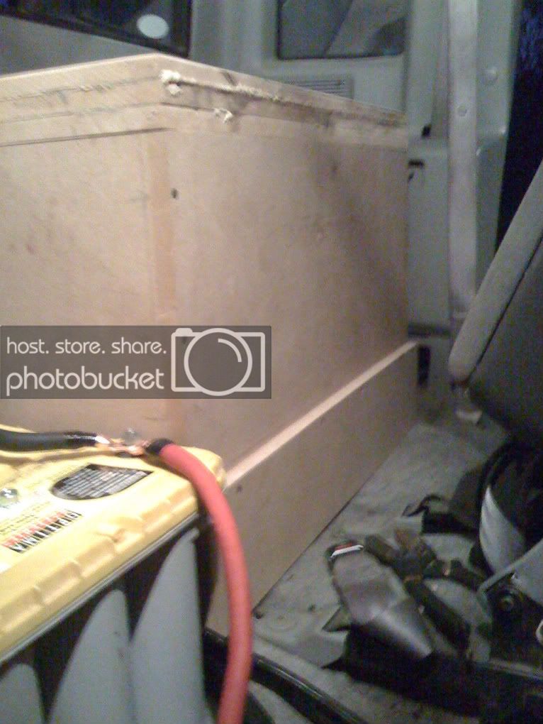

The box is 2.6 net tuned to 45hz, triple baffled on top, i'll get more pics of the box later. Its subs up ports on bottom to drivers side. Braced the **** out of it, this thing is solid.
amp will be mounted on the front of the box in an amp rack so its not so thief friendly.
