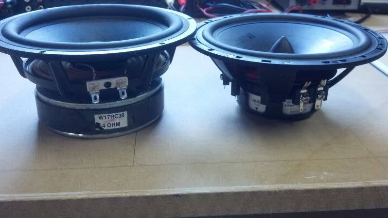

Silver Flute (left) next to a German Maestro Status (right)

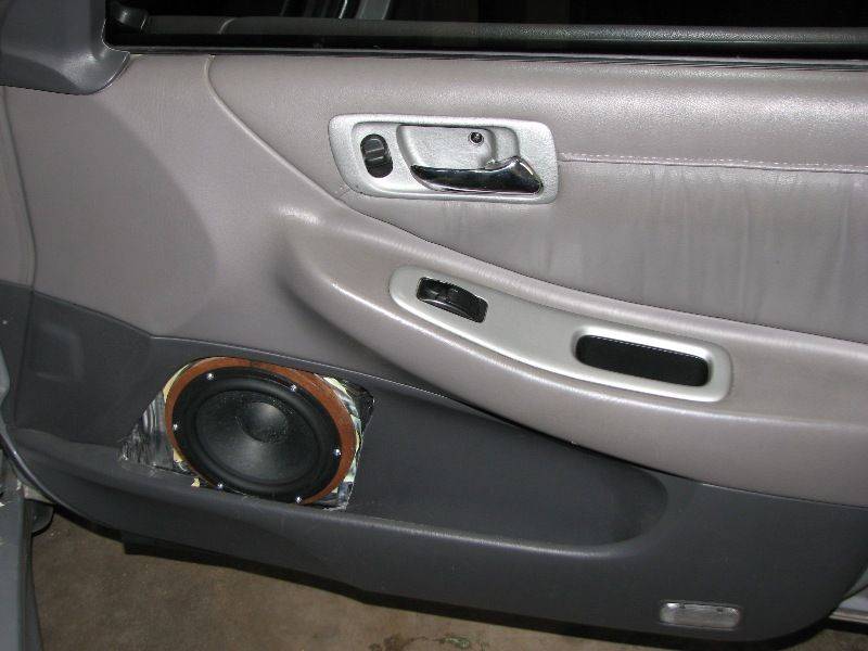

Silver Flutes mounted in doors
These woofers are beefy and deep - 3" deep when mounted. many cars cannot handle that size/depth so using these woofers forced me to make panel modifications

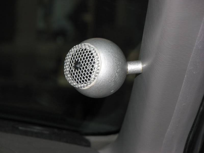

Vifa ring radiator tweeters (faceless) mounted in spheres
