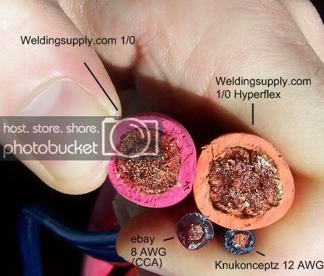

Don't be tempted by cheap kits on ebay. You probably won't get what you're expecting. In the pic below, the smallest red wire is "8 gauge" power wire from an ebay kit. Notice that the actual wire is smaller than the Knu 12 gauge speaker wire. Also, the ebay wire is copper coated aluminum. . . so it will perform like even smaller wire.
