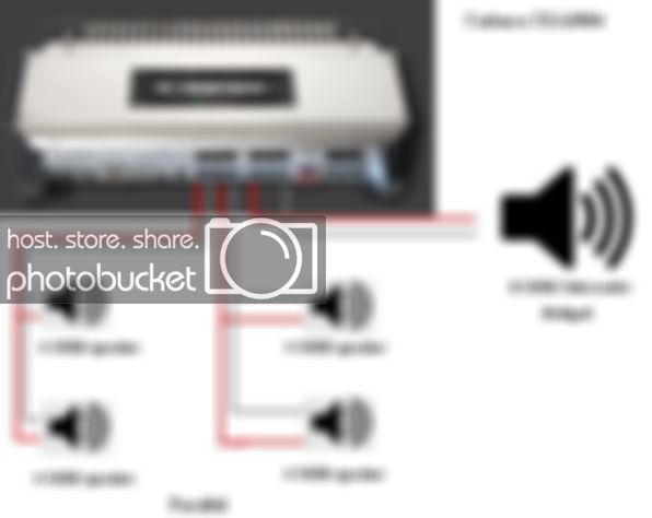

so i just got my amp and i was wondering if this setup was a good idea...
input please!!!
if the 4 speakers are meant to be in front AND back, you will have no fader adjustment to balance level from front to back. Otherwise it should be fine if the amp is 2 ohm stable
