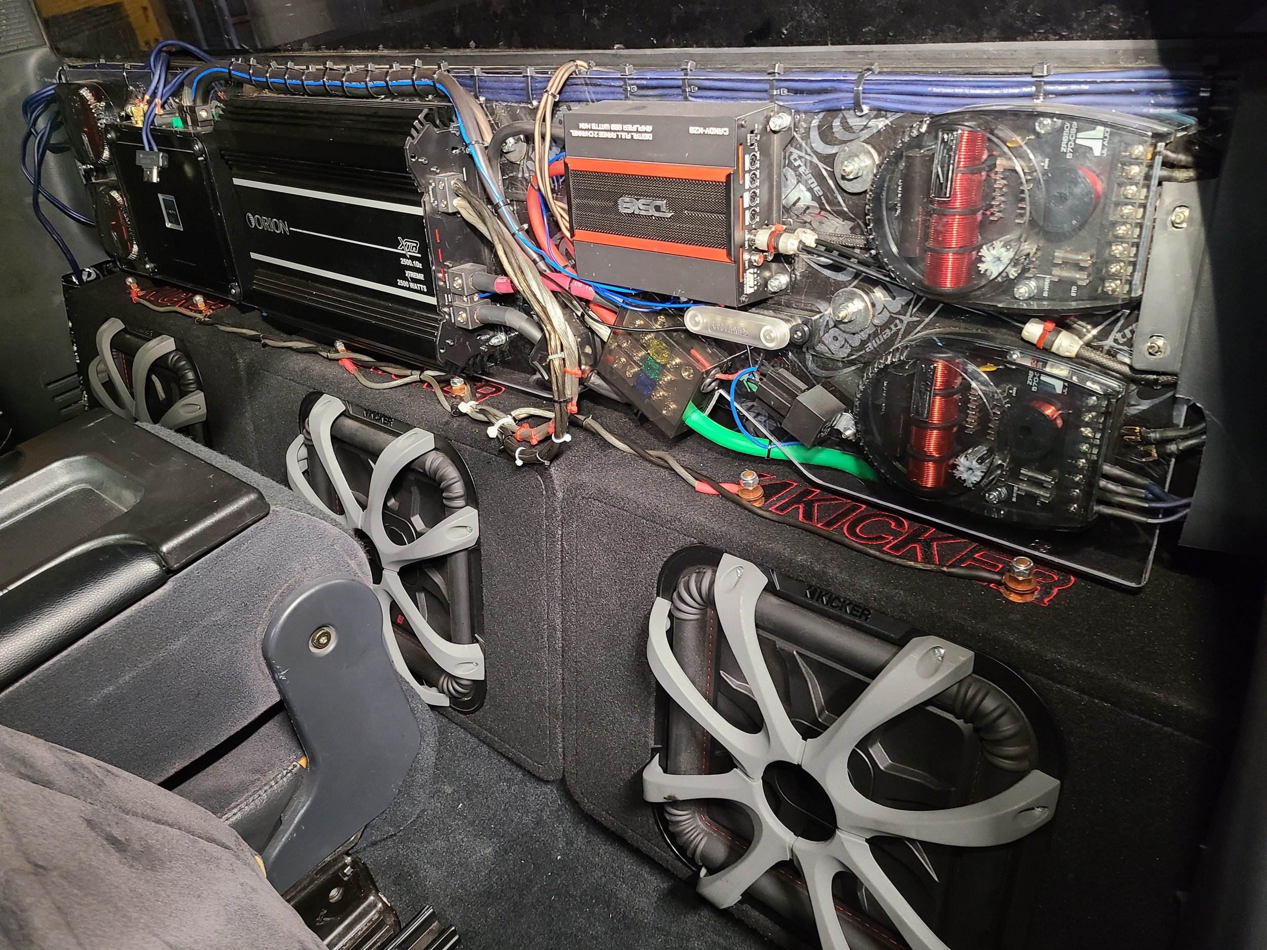

Here's where I put mine. You didn't say what cab size you have. Generally under the front passenger seat or behind the rear.

Holy moly, that is a beautiful setup! I have a single cab so I will probably have it under my passenger seat. Your is really Impressive!
