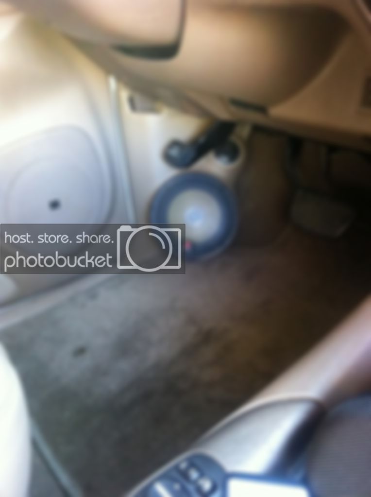

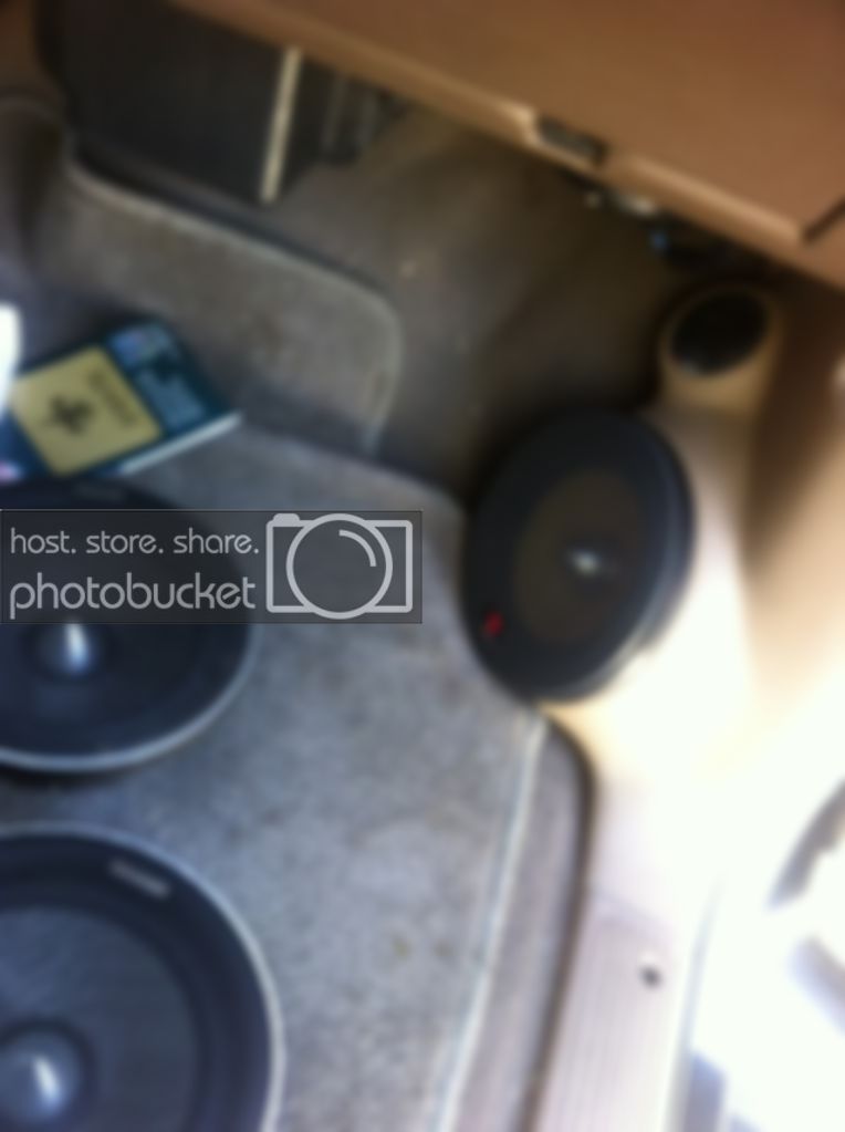

Im have a dilima in my Sequoia. I just recently installed a set of Focal 165 k2p components in some kick panels. The only other speakers I have in the truck are my subs. My problem is it sounds like the sound stage is waaaaay too low. Like literally coming from the floor. Now I installed the tweeters and the midrange drivers in the kick panels down by your feet. Is this the problem? I always thought the speakers were supposed to go down there.
I wanna bring the sound stage up to ear level. What would be the easiest way to do this? Would installing a 4' and tweeter up on the A pillar do the job? Is there an easier way than that?

I can see right away a major problem with those kick panels. That's the worst possible angle for the tweeters. They're firing straight into the bottom of the dashboard, and on the driver's side the parking brake lever is also causing problems with reflections. The best solution would be to put those kick panel enclosures in the trash and make new ones after experimenting with aiming of the mids and tweeters.
I don't know how the off-axis performance of those Focals sounds but you might be ok leaving them where they are, but again not in those kick panels. Re-aiming them with a towel behind them would be better than assuming this orientation is ok. Try moving your head so your face is close to directly in line with the phase plug.
I could suggest a product that would easily raise your sound stage, but I think it's better to get your value out of those Focals by improving the install first.
I agree with Trumpet. Its become a pretty common misconception that if you put your mid and tweeter in your kicks that you will automatically just get great imaging and staging. If that were the case, everyone would just go grab some prefab kicks and go compete SQ. When it comes to running comps in kick panels, aiming is critical. There's so much stuff down low to block/ reflect sound that you have to compensate for. Then even after compensating for parts of the car, there's still, in some cases, your own leg to consider that could be causing issues. Kick panels can be great but they require work and, from what I hear, alot of trial and error.
If youre not really up to perfecting kicks, you can just perfect a door install for your mids and then find a higher spot for your tweeters (but you will still need to play with aiming and placement here too). What kind of HU do you run? Some time alignment could help as well if you decide to go with doors and even in kicks at times.

Maybe you can use the same kick panel and just add something to angle the tweeter better! I don't see the angle of the mid being a problem but I do see an issue with the tweetsr though! You'll be surprised how much something so little affect it. I have the same type of set up and when my gf sits in my car I have to tell her not to stretch her legs out because it blocks the sound a lot!!
Or you can get some butyl rope (whatever the name is) or some of the clay thing ppl use and put it on the side of the tweeter you want to lift to angle them better! If they work well but look awkward then you can try to use the kicks as a base mold but throw some FG on top to make it look better and make them stronger!!
There are problems with having someone else build speaker pods for you. 1) to get it right requires testing different positions 2) even if they have the same speakers and the same vehicle the builder doesn't have your ears and your listening preferences 3) not every mid and tweeter sounds good with generic aiming, i.e. toward an invisible point between the headrests
I second the opinion of moving the mids into the doors and trying to get the best sound from those locations. Generic kick panels don't have much air space, and those mids will probably sound great in your doors.
