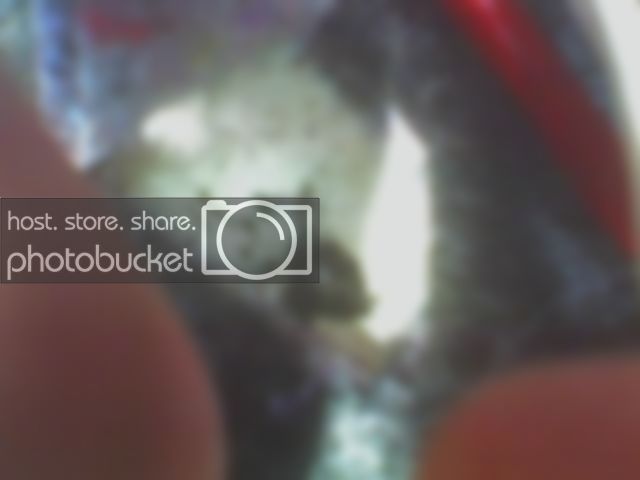

Anyways here's a pic of the stuff, the best i could get
The stuff is white speckled with a little black, and a has the texture close to that of an orange, in that pic a little bit is scraped away and in the inside is some kind of dense brown stuff. I seriously have no clue how i'd get that stuff off if i had to it is glued on there tight.
Oooohhh Ford with their "We've got a better way to do it" attitude. Maybe you should try just sticking it over it. Maybe spray a liquid deadener right into the carpet stuff?
Hmm, how much does a liquid deadener cost and where can i get it? Ohh, and it's not carpet stuff, it is quite hard actually, nothing like carpet. Had to scrape it away with a knife.
