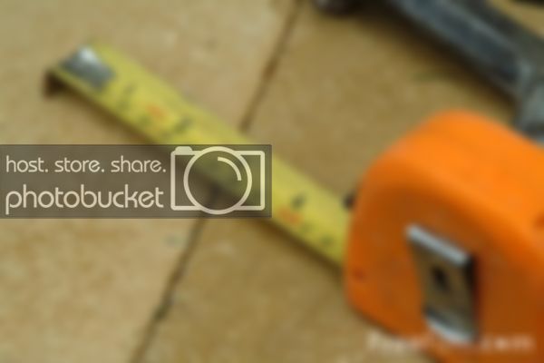

Approximating square footage is very easy using one of these.
