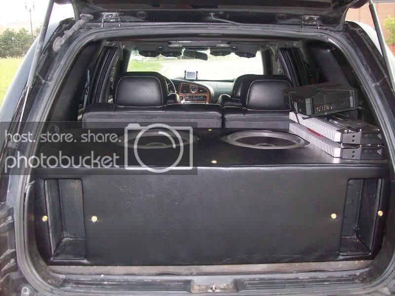

Had my stereo hooked up for a little while now, figured they might need to be broken in or time to unstiffen, but I think ive got a good problem with my subs/box or amps.
Im running 2 audioque sdc 2.5 15's, and 2 cadence txa 1000D's. Each amp is running one sub @ 2ohm (650rms)
Its a common chamber box, t shape (beauty panel on top hides that) with a dual port with a 38hz tune.
I personally think it hits pretty hard, makes ur nose itch and the mirrors go crazy and what not. But I dont think its even close to as loud as what some people are running with the same stuff or equivalent. Ive never HEARD louder though, but nothing is in my area. Whne your in the car obviously you can feel the bass, but you cannot feel it if you walk like 5 feet from the car with the doors all shut, just hear the comotion inside lol
Take a look at this vid showing how much the subs move, they barely move, maybe 3/8" total. Some people seem to move over an inch....
http://s52.photobucket.com/albums/g28/905ef8/?action=view&current=100_1180.flv
http://s52.photobucket.com/albums/g28/905ef8/?action=view&current=100_1181.flv
So then I thought ok maybe one amp isnt even working. And the way I have my rcas run is from the HU to the top amps INPUT rca's, and then from that amps OUTPUT rcas to the bottom amps INPUT.
So when I disconnect the top amps OUTPUT (meaning the bottom amp isnt getting an rca signal) the subs move MORE, they definetely were wanging in and out noticeable more as I could watching the path the sub stitching took, plug it back in, stopped moving as much. BUT, when I disconnected the rca's like that, they didnt have as much output..... weird?
Heres a vid of the hatch of the car for reference. Thats with 3 layers of sound deadning and the latch as tight as I can get it. Moves alot, but its really not all that loud inside the car.
Im having a tough time deciding what to do. I originally wanted to buy 2 more subs and make a wall because I wasnt happy with the output. Now I may just rebuild a box thats more basic with just a single slot port. Or there may be trouble with my amps I dont know I need some help with this one
thanks guys
