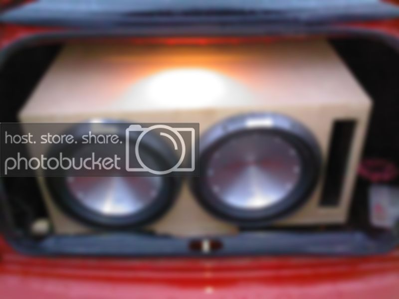

so i made a new box today...

i had some house speakers with dummy speakers as i call them =] they sounded great too be small. but yea i wanna make a bos with interchangable ports that u bolt/screw on.
and with the current problem i have if i made the port come out of the box would that help or is the port just too small.
Port is too small. Look at it this way, your already tuned at 26hz, any lower won't magically give you lows, even chopped and screwed stuff goes to 25hzish at lowest usually, most of that bass is still around 30hz. Tuning at 20hz and sealed are almost the same thing, 15hz and sealed will model identically usually, unless you use alot of airspace and really make the port massive, like in a home. Right now your subs have lots of room, your port on paper should be providing lows. All those things are usually good for lows, yet your lows aren't good. The only thing left is that your port is too small. Download tones and mess with the box if you want to double check. Download a 25hz tone and you'll probably see that maybe half way up the volume knob it stops getting louder. Compare it to a 40hz tone, 40hz will probably have a lot more linear volume increase as the knob goes up. If that is true, the port is definetly the issue.
yea thats how is does with the higher notes. it just keeps gettin ****in louder n louder. i mean its nice as hell to be loud but thats not me lol. so i built a nice box but its wrong =[...
so how big should a port be for these subs. i dont want an l port just a single simple port. if u can give me those measurments that would be great if its possible, or give me the absolute minimal for around 24-7 hz.
thats the box to whom is curious
