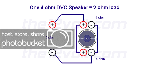

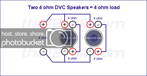

So how do i wire the dvc's in the enclosure correctly? Positive to positive and negative to negative?
It isn't going to make any difference which way you run the amp. It will do the same power @ 2 ohms per channel or @ 4 ohms bridged.
So, wire each sub like this:
Or wire the pair like this and bridge the amp:
