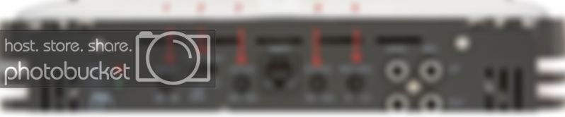

MB Quart DSC2150 Discus Series 2-Channel AMP, need help with seting it up, i have no clue on how to do it. i numbered all the settings 1 2 3 4 5 to help. it will be running 1 pg rsdc 12 2 ohm, the amp will be at 4ohm x 1 at 600w rms...
1st you need to have the RCA y connector. Only use one side (either is fine) from the hu and y it at the amp input. Then set the switch to LP (low pass like u have it). The high pass dial is not functional so don't worry about that one. The other 2 are like gains. One for how much you want the signal from the hu amped, the other how much much extra low tones coming out. Since you are only using it for a sub, they will basically be the same thing. Start like this:
#1 all the way counterclockwise
#2 LP
#3 little less than half (this is how much mid vs. True bass gets out)
#4 doesn't matter
#5 middle
Play with 3 if the tone is too high coming from sub and 5 for more or less bass
