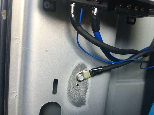

From what it sounds like you may have damaged the head unit. The test he recommended will at least tell you whether your amp is okay, but as for the head unit it doesn't look good if there are no blown fuses. I'd check all the wiring, make sure the voltages are there that should be and try pressing the ground cable into the chassis, sometimes when grounds look secure they're not. 12v DC can be very hard to ground properly.

I literally sanded the paint down in a spot to get a good ground and still no head unit power.
Here is my ground.

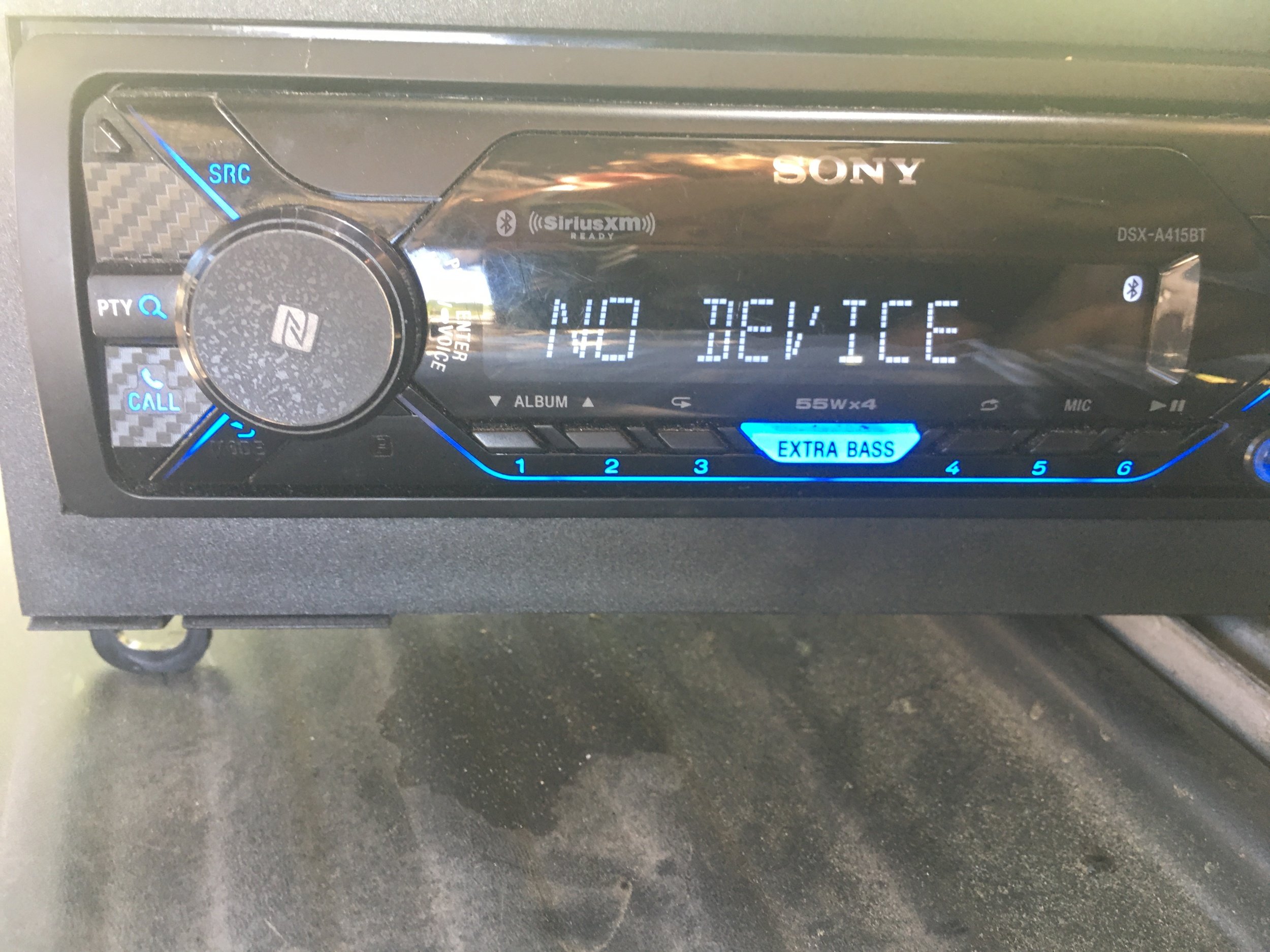

Okay so I checked the media player on the car battery and it works, it lit right up.
So now I know the amp and media player are both good.
any idea why I wouldn’t be getting my 12v if my ground is good?
