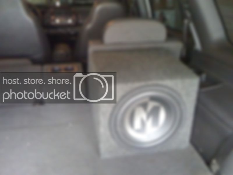

This is my first install. Not a lot of power, but its a start. I need to replace my old RCA's and deck. I'm trying to solve the popping noise when I can the change the radio stations and going from fm to cd to aux. it all pops. I regrounded my deck and still does it. Need some help one that.
She pounds. I still need to install my amp for my doors. But I'm waiting to build a custom box for the sub.

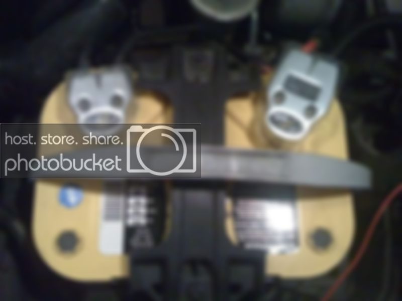

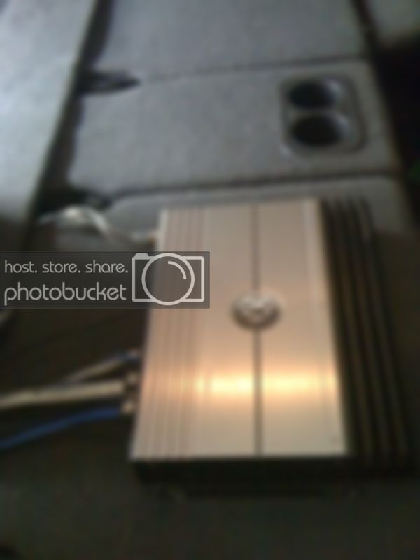

I bought a yellow top optima battery, I put a 4 guage wire from the Alt to the Battery and upgraded the wire from the fuse box to the battery. The ground wire to the battery is upgraded too. With just one amp my lights are dimming. The sub is wired at 1ohm. I'm afraid they are going to dim more when I add my second amp, my lights are really going to dim. Any thoughts on what I need to do.

I'm assuming the sub is bridged? Is the amp rated down to 1 ohm when bridged?
HIDs will stop your headlights from dimming, but that's just a band aid for a bullet wound. If you're dimming, you need to add more electrical.
Adding a wire from the battery to the fuse box isn't going to do anything. You need to go directly from the battery to the alternator. You have to also do your chassis and engine block grounds.

I added a wire to the from the battery to the Alt. So I need to add more ground wire? Any where?
The sub is wired neg to neg posi to posi. Can you bridge a Mono block?

Now you need to ground from engine block to chassis. On mine I went from alt case to strut tower. And you're at 2 ohms from what I can see off your sig. Your sub is a D4, not D2.

Battery positive to alt is correct. Now you have to do the battery negative to the chassis ground, and the battery negative to the engine block.

Well i moved the ground on the H/U to a better ground and it help. But I still told my wife to I need a new deck So I'm looking into a kenwood Nav.
I went with Coax, at the time I couldnt spend that much money. They sounded better than my stock speakers.
When I get home sometime next weekend. I'll play be adding more ground wires.
