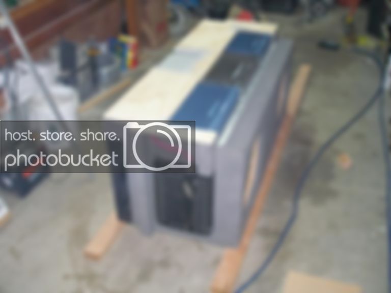

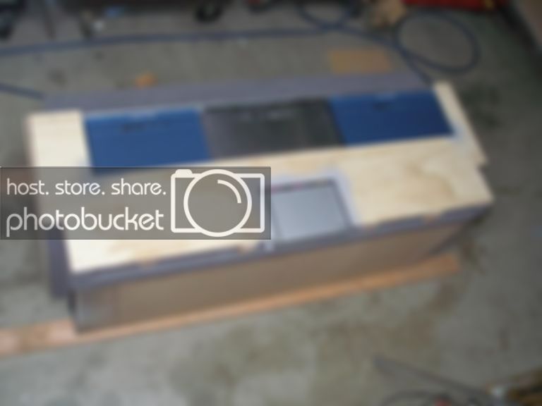

Ive been sick, and have some real-life issues going on, so not as much done as Id hoped. Finishing up the beauty panels to cover the wiring. They aren't carpeted yet, and I have a few more details to finish up on it, but you'll get the basic idea I think.
I decided for a slightly less traditional method of covering the amps... leaving the tops exposed as well as the front. Better heat dissipation... plus I just like the logo's on the tops of the amps. //content.invisioncic.com/y282845/emoticons/laugh.gif.48439b2acf2cfca21620f01e7f77d1e4.gif

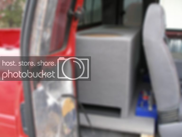

Here's box when it was being test-fit (sorry to guys who already saw this photo)...

Now my slow down is trying to figure out exactly how I want to wire up this stupid second alternator. That plus I need to do another test-fit of the box and nobody is around to help me lift it into the truck. lol
