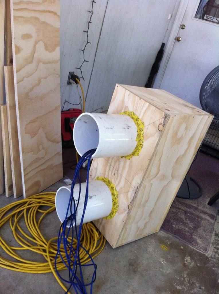

I don't even understand that (2) 15's box. I look at it and scratch my head. But it works.
This is the 12's box.
The single 12 box.
This isn't the 15's box I use now, but it's close. This one is v.1. I'm on v.15. Lol.

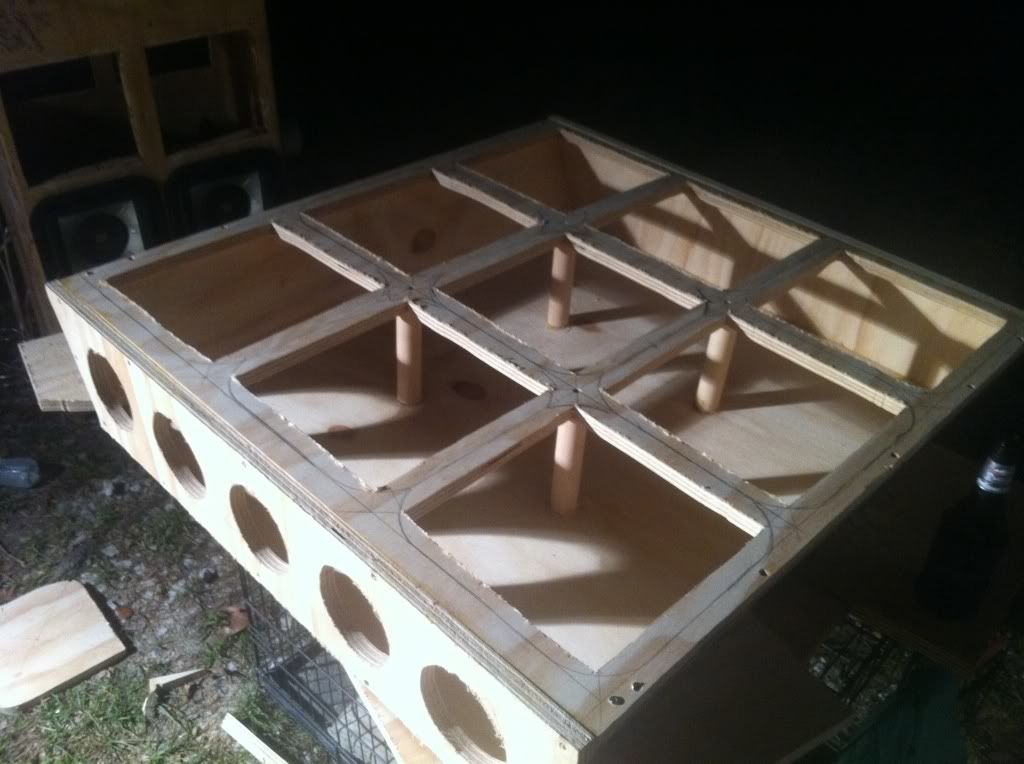

Or perhaps ~ 3cf for (9) square 10's. This one did 155+ with Pyle's.

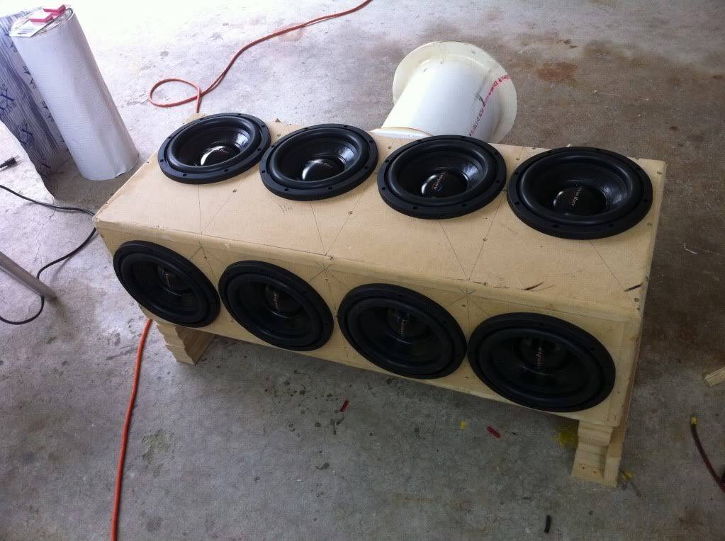

Maybe 2cf for (8) 8's? This one was louder with (4) though. It's not always a win.
