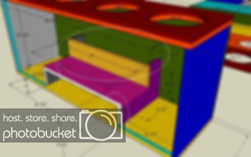

im bored at work, so i circled some things on your box to do. All the port corners and
90's should be rounded, the smoothest transition as possible. I do not think bracing
will be needed due to the port and short depth of the box. I would resin the inside
of the box / port to smooth out things as well.
