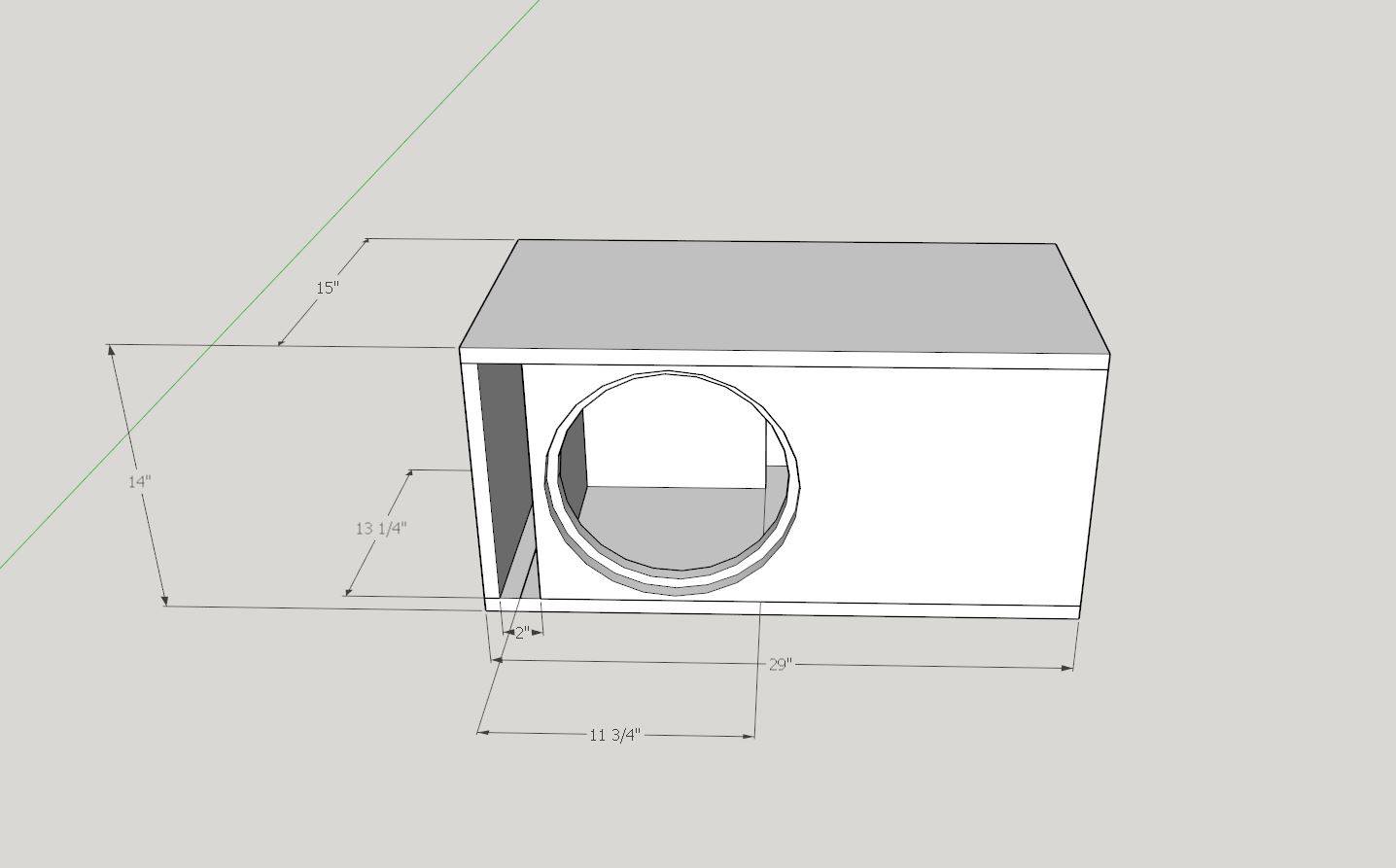

i'll play 1.8cf ad 35hz box 29"w 14h 15d (recessed double baffle) 2"x 12.5" high port.. port should be about 26" long..
Sketchup is really fun once you get it down. Having keyboard shortcuts makes it nice. I make every piece separately and make it a group. Then, I can pull each piece off separately. It's also nice because I can select all the volume on the inside of the box that the subwoofer sees (area minus port obviously) and sketchup will spit out a net volume for you.
One thing i'm not for certain though...when designing the box for port length, I measured from the middle of both port pieces all the way down. That's what the 13.25" and 11.75" measurements are...which is 25" combined. But, for the end correction, I read somewhere that you take half of the port width and take that from the length. Do you have to add that to the length or subtract it? I subtracted it in this example for the 26" requested length but I wasn't completely sure on that. Although i'm sure the difference wouldn't even be audible.

Measure the woods length. The correction factor does the rest

cool man., looks nice .. yeah u doing right measure down the middle of port,seen some (online) programs subtract whole port width from length, some subtract about 1/2, some don't subtract any (wins is usually shows longer port length) so i subtract 1" (i'm always doing 2-2.5" wide port though) from whatever it shows..
