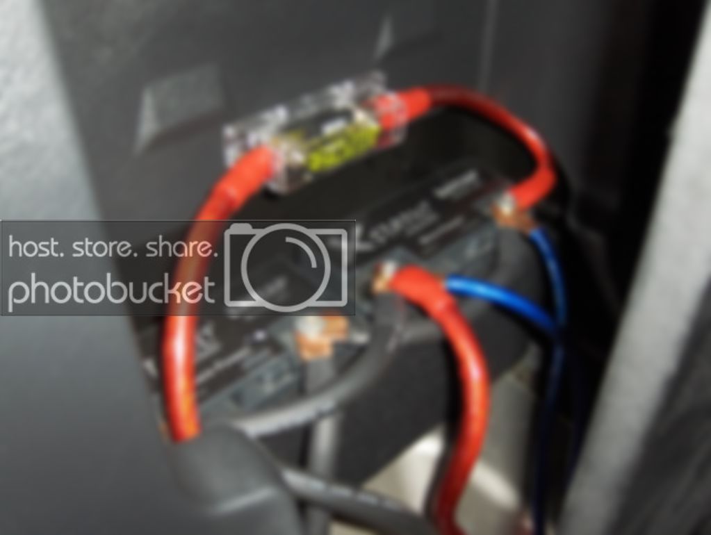

heres a pic when i had 2 batcap 800's, they are very small and handled my 2000w rms at the time with ease, with an optima up front. i never went below 14.4v once above idle
as you can see, they are very small, not much bigger than the 1/0 and 2/0 LOL
