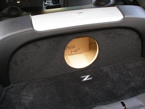

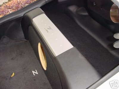

Just picked up a Nissan 350z and want to add a sub. I found zenclosures.com and they make a very nice little box that tucks under the rear strut brace trim. They claim the box is only .75 cu ft and wondering what I should do for a sub. I was thinking about getting a single IDQv3 10 but wondering what else people would recommend. I also can get a deal on Diamond Audio D3/D6 but haven't really heard their stuff. Amp will either be a PDX 4.150 or Sundown 100.4 and Id like to just bridge the rear channels to the sub which would only give me about 300-400wrms. If needed I could add a second sub amp and just get a 2CH for my front components, but if possible would like to stick with one amp...what do you guys think??
Pic of the box (Comes in Single 10 or Dual 10)

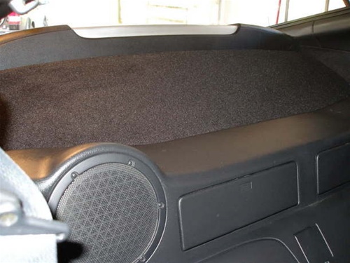

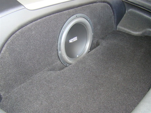

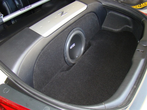

I think I like the idea of running a single ten..I just threw dual 10s on there cuz I saw they sold it, but that really isnt enough volume for 2 subs. There really isnt alot of room to work with so ported is pretty much out of the question unless I made a box extend out behind the strut/tower area(pictures below) but Id rather save the cargo space since this thing is tiny enough, I would assume a single 10" inside this small of a cabin would give decent results...Just looking for opinions on what would work in this small of an application...They make the box in a 12 as well but it looks kinda lame with having to trim out the carpet in front of the sub:

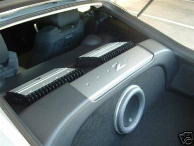

Here is with their "amp rack" which could be an expansion onto the existing enclosure for more volume I would think
