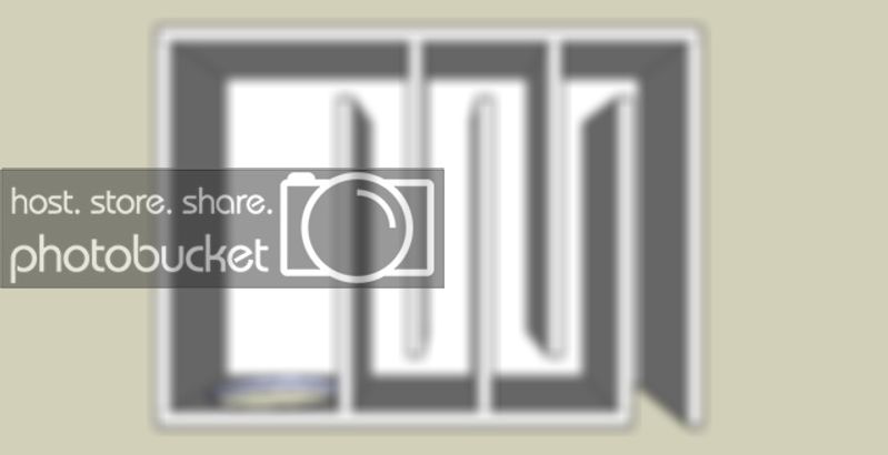

What is it? Im sure some of you recognize it. Its just a simple transmission line (1/4 wave of the frequency) tuned to around 34 HZ with a catch. It has a compression chamber which is basically an enclosure to bring a little more low end out of the line. What does this mean? Anything in the 20s is now loud and clear and nearly flat just as i wanted from mid twenties to around 60.

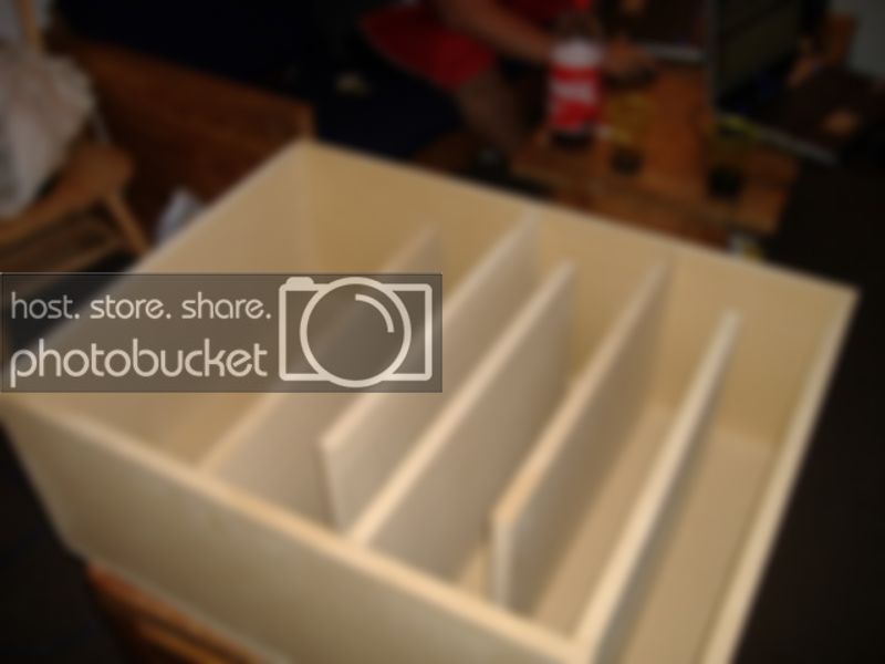

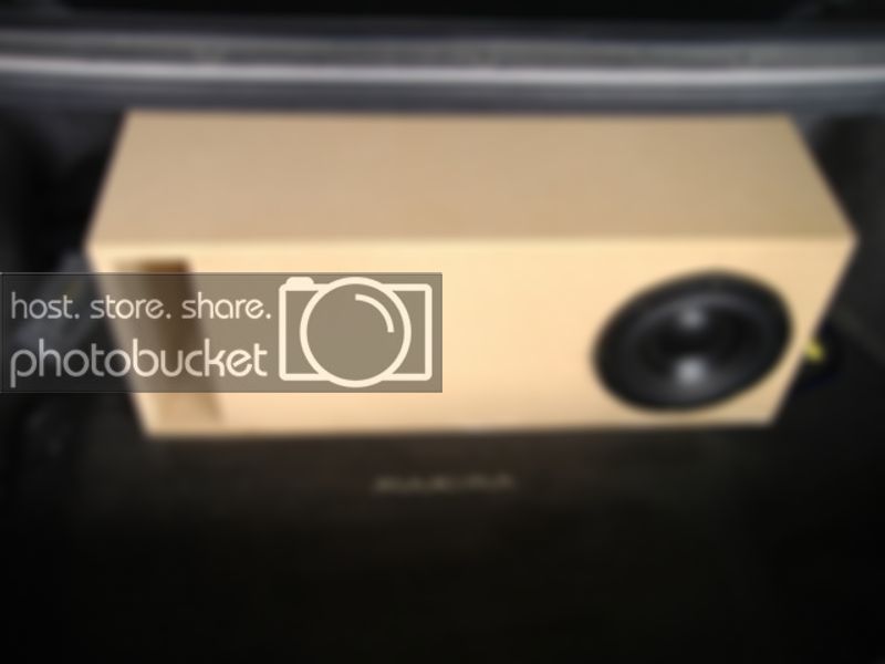

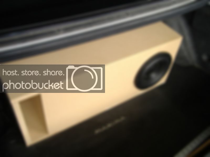

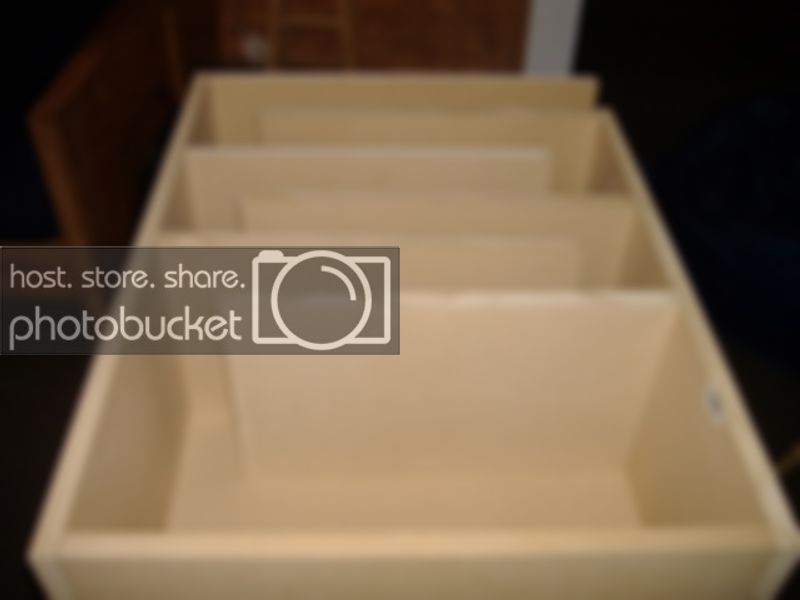

And now for a couple more pics:
Mock up:
Sorry I dont have more pics....Enjoy.

Cant say I have, I started out with a line tuned to 35 and looked OK, but it wasnt quite what I wanted. It was another member at DIYaudio that suggested I lower the CSA and add the compression chamber. Im starting to get then hang of it though. Im making one for home soon...

The member over at DIY suggested I didnt because it introduced more upper harmonic noise that I didnt want. Above 80HZ it has huge dips and peaks that would have been more noticeable. For this reason, I forgot to mention, it requires a steep Low pass at 50 HZ 24db/octave
