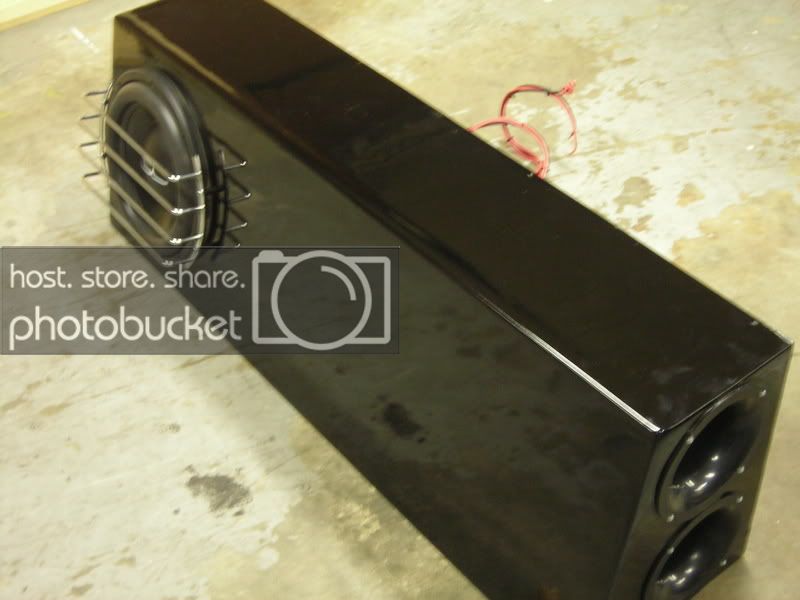

i did a 12" FI Q in my buddy's ram...about 2.5cubes tuned at like 30hz...sounded good and got plenty loud...
I actually have a 99 Dodge reg cab with a Bl 12 behind the seat. It is powered by a Powerbass ASA1500.1, and is sitting in a 2.4 cube box tuned to 30 hz. I didn't have to move the seats forward or anything, and it still fits good. Oh and by the way, it absolutely pounds. I cant wait to get it on the meter, but that will probably be another month away.
well we had to weld on some new brackets to the center consol to move it forward a couple of inches and had to gut the truck to get the box in....but we could have just made it a little wider and not so deep and it probably would have fit with no adjustments....
