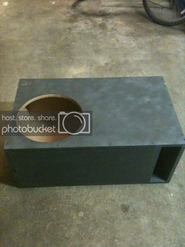

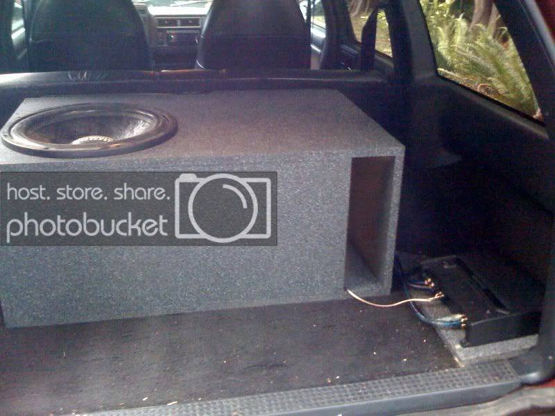

Simple box build. Sundown E15 off Kenwood 8105D
Weeznur32

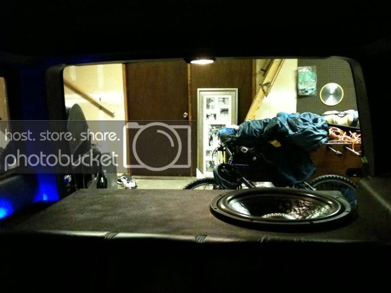

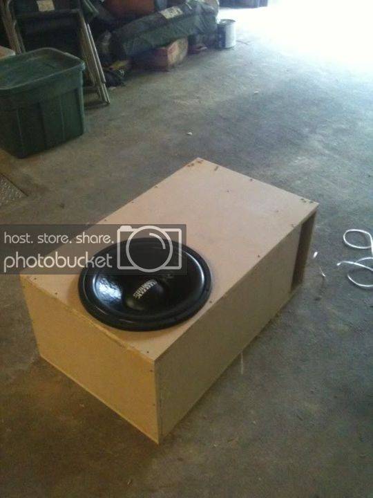

I am VERY impressed with the sundown E15. This thing gets F'n loud for only taking 500w and with voltage its realistically probably more like 400.

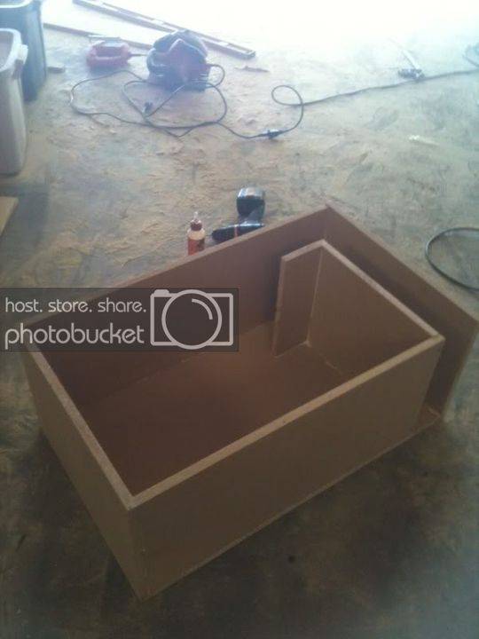

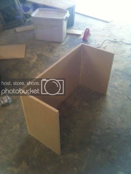

This is a ported box designed by buck... 4 cubes tuned to 33hz

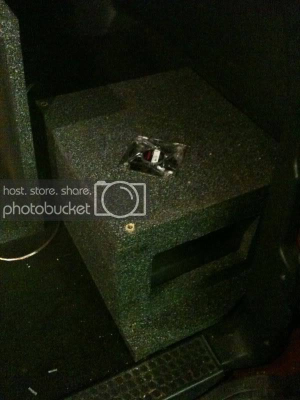

I decided I didn't like the wood so I painted it with textured spray paint. Turns out its pretty much just normal rattle can paint. Going to either get flekstone or some carpet tomorrow.
Here are some videos...terrible sound quality //content.invisioncic.com/y282845/emoticons/frown.gif.a3531fa0534503350665a1e957861287.gif
OVERALL: Very happy so far...
Will update with more pics of stuff soon....
no bracing???
He's running it off like 400w, bracing isn't really needed lol. Honestly you can build a big setup before needing bracing. A lot of it comes down to your assembly of the box itself, how strong the joints are, etc. I didn't brace the box for my 18 and it didn't flex at all -- same with the 4th for my 12.

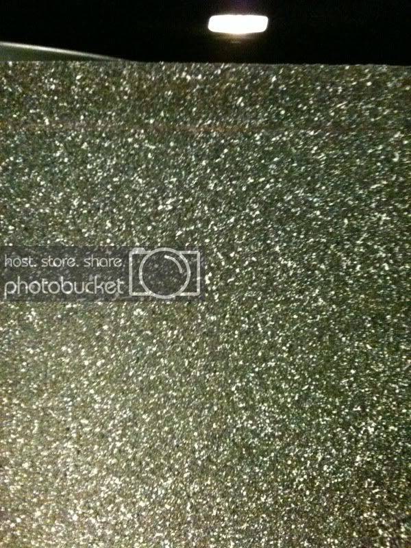

OP I like the look of that flekstone...gotta close up shot?
---------- Post added at 09:38 PM ---------- Previous post was at 09:38 PM ----------

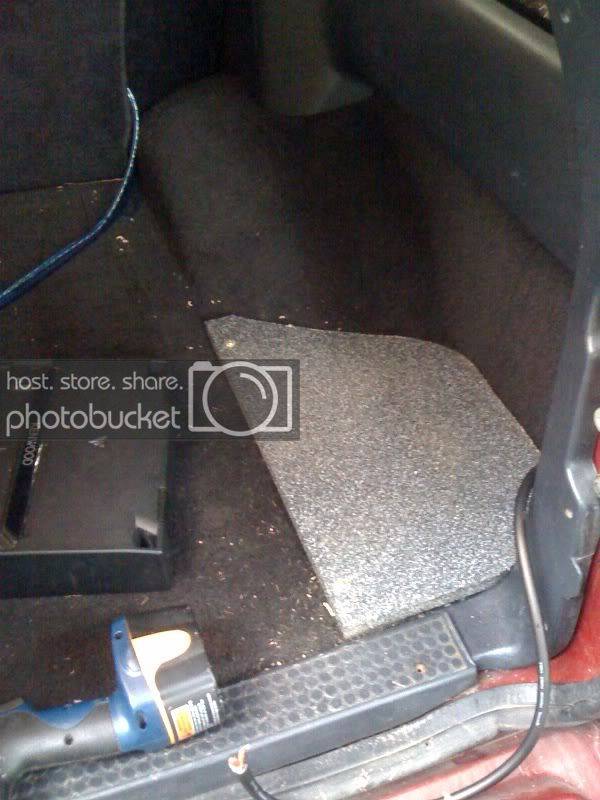

Here is a close up:

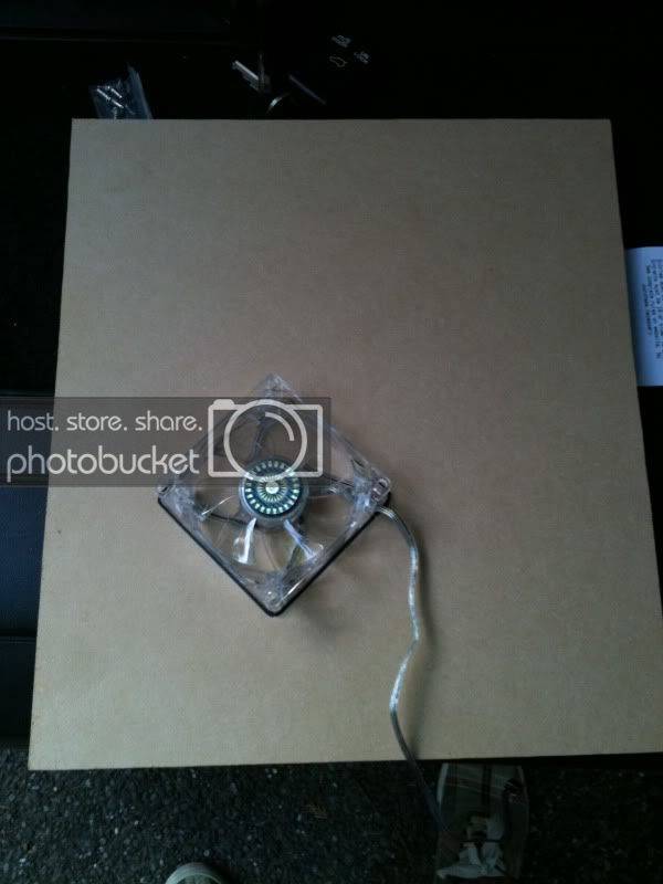

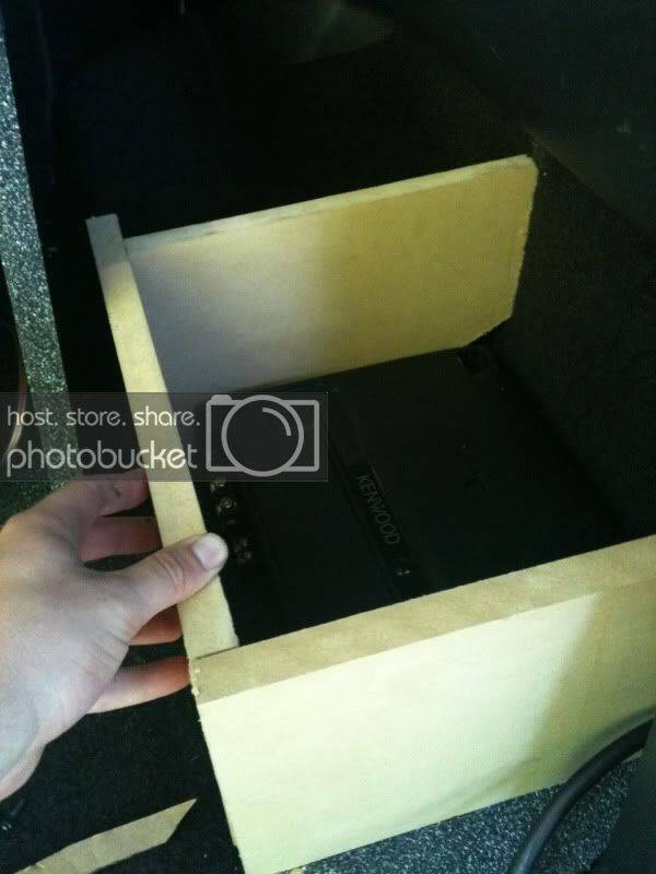

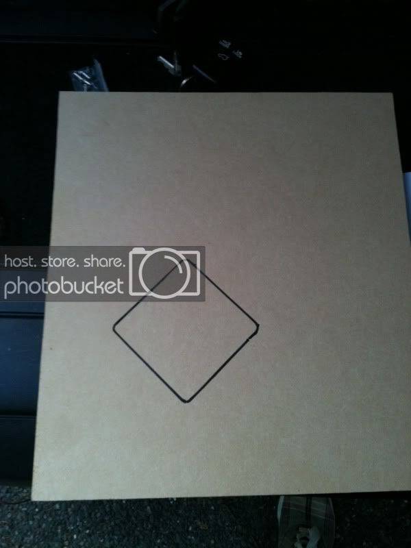

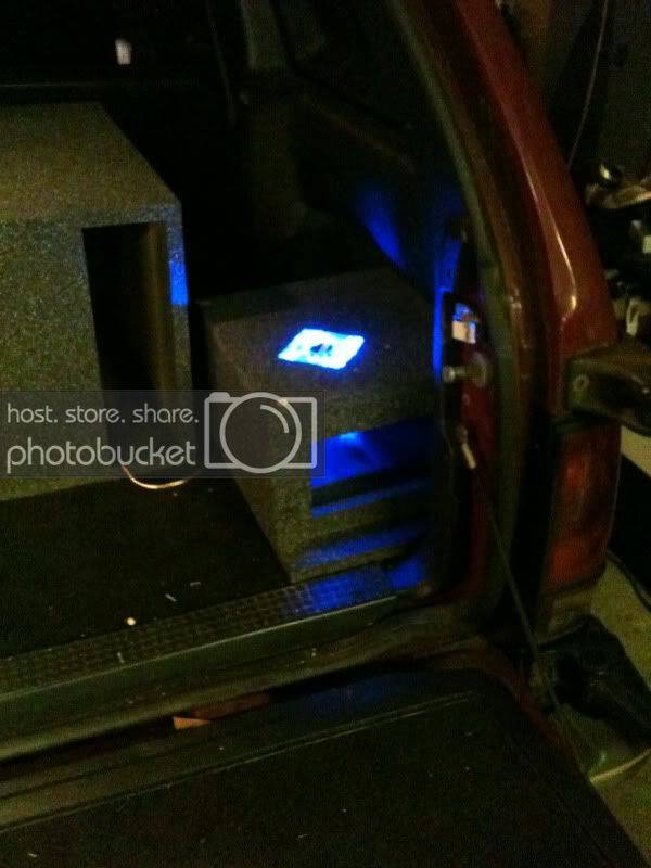

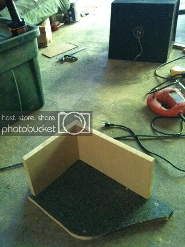

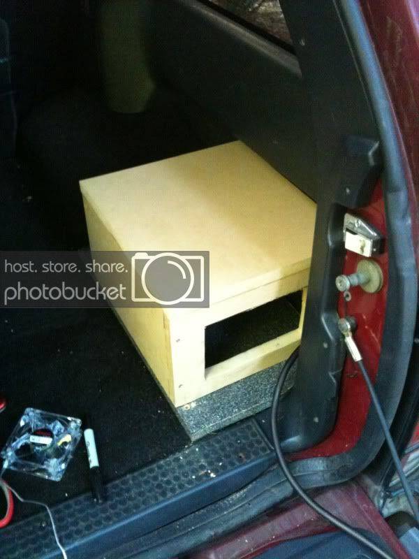

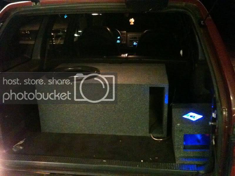

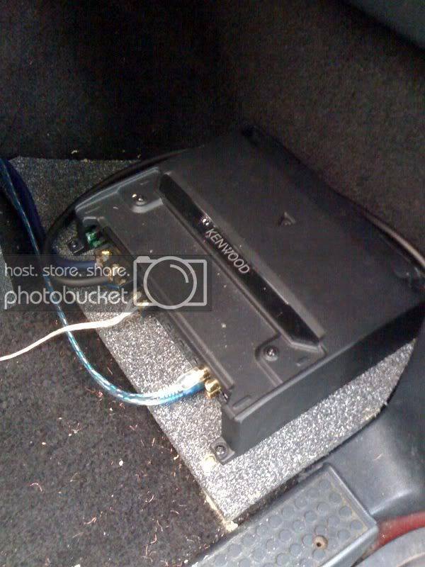

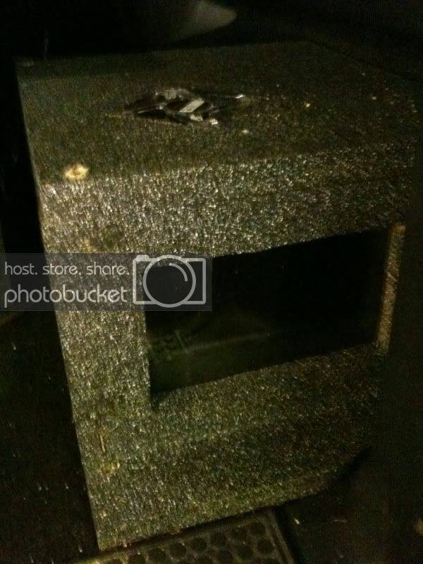

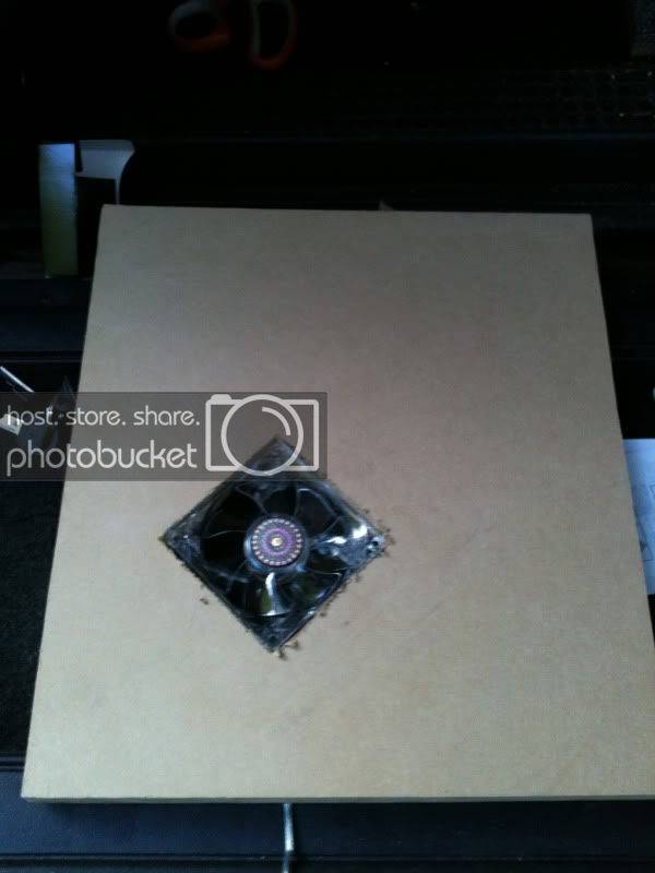

Here is what I got done today. I didn't like the amp just sitting next to the box exposed with wiring and everything. My brother puts his lacrosse gear in this car all the time and I need to make sure the amp doesn't get completely fucked. SO i decided to build a box to encase the amp. Here it goes...
Looks nice. I like the amp "box" you made. What size is the PC fan? Also, I don't care for the speaker wire coming out of the port, I'd install a terminal or just drill a hole and seal it. But that's just me.
80mm fan. And yeah it is definitely bugging me now that the box isnt just bare mdf and the amp isnt just laying on the ground. Ill definitely drill a hole in it when I get around to it.
How is the airflow for the amp? If it's getting really hot then I'd recommend a 120mm fan.
I'm not a huge fan of bare mdf. I like the box to at least be painted. The fleckstone is a nice unique touch.
Pick up some 1/4" threaded rod from lowes/home depot, some washers, wing nuts, and some 8g ring terminals. Drill a 3/16" hole for the threaded rod, put the rod in the drill and then drill it through the box. Then put all the parts on, using the ring terminals on your speaker wire.
