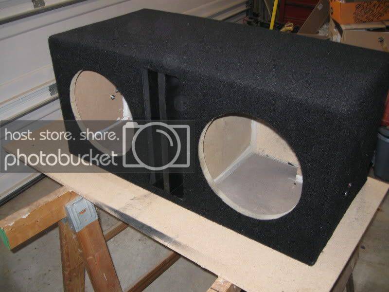

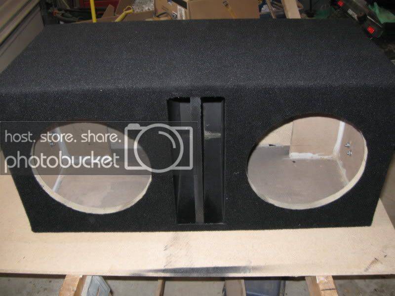

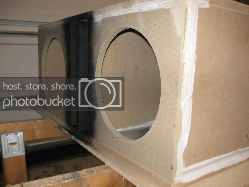

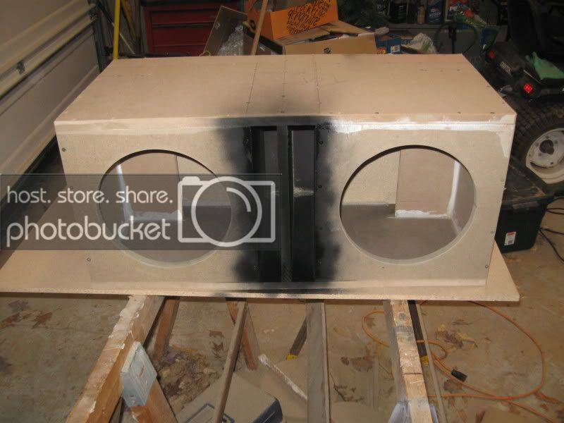

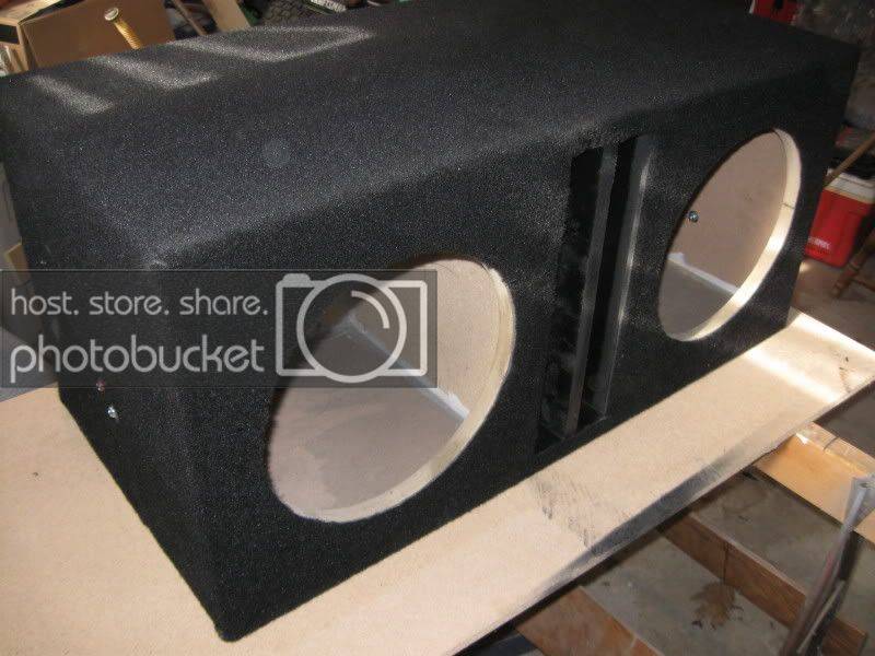

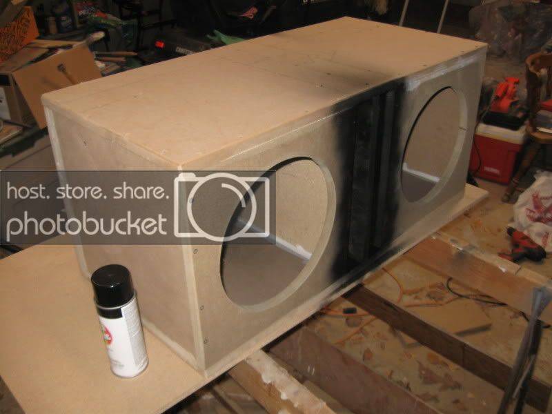

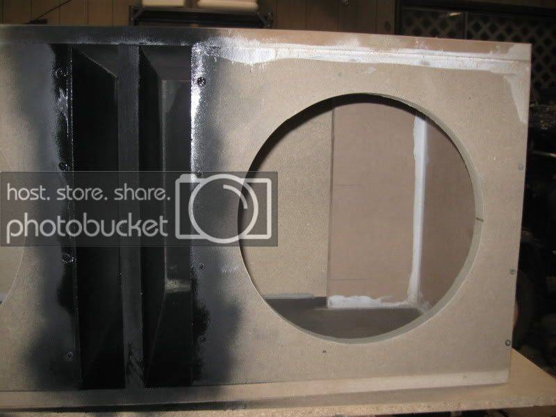

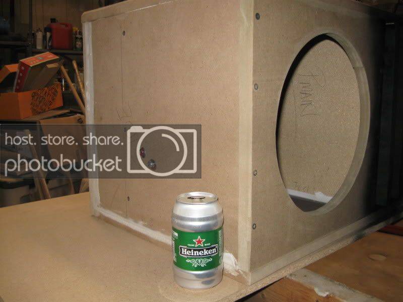

i brought it upon myself to build a box within 5 hours from start to finish.. i did so without the help of a router and tablesaw.. *sigh*
it was difficult, but i managed to make someone happy
2.1cu ft 35hz per chamber.. 29sq inches of port
i didnt help the guy install the subs, instead my only responsibility was to build a box quickly
the box is for a pair of RE SE 12's in the trunk of an 03 impala
