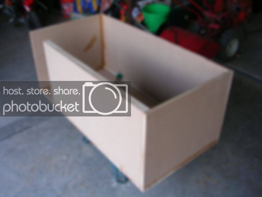

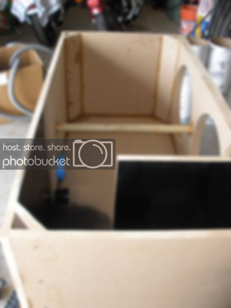

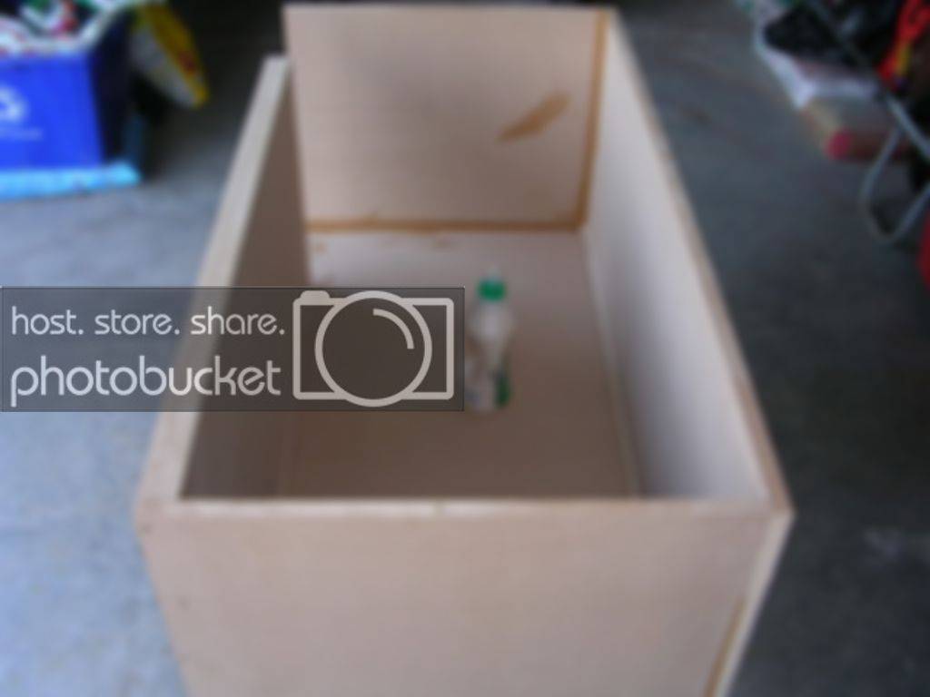

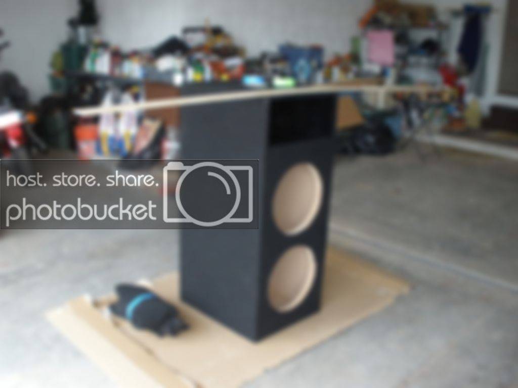

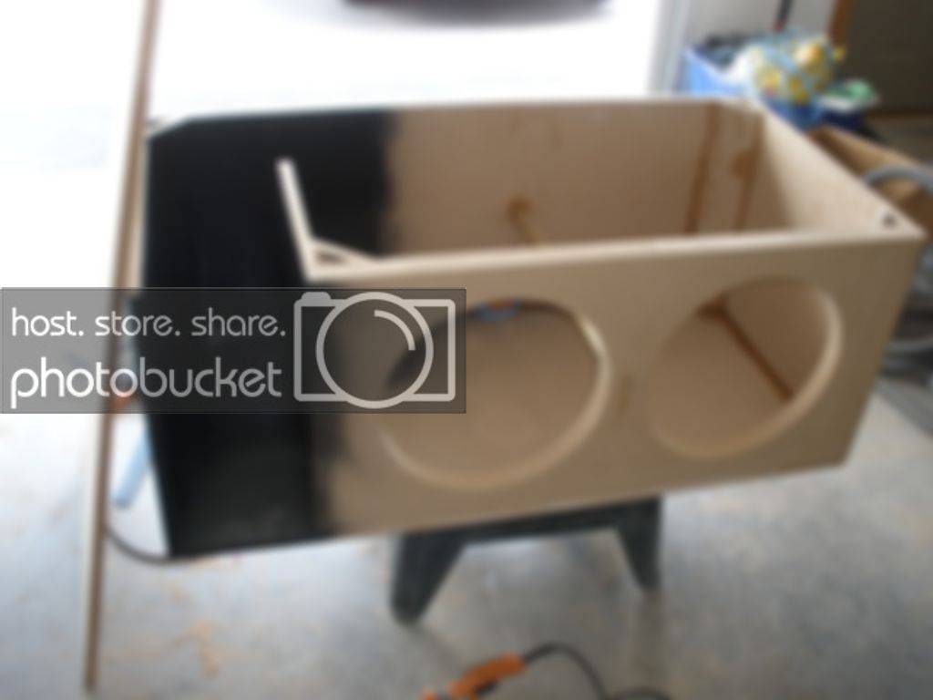

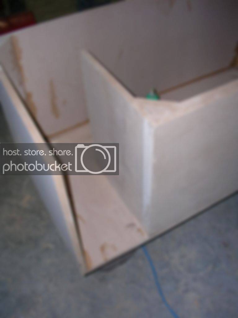

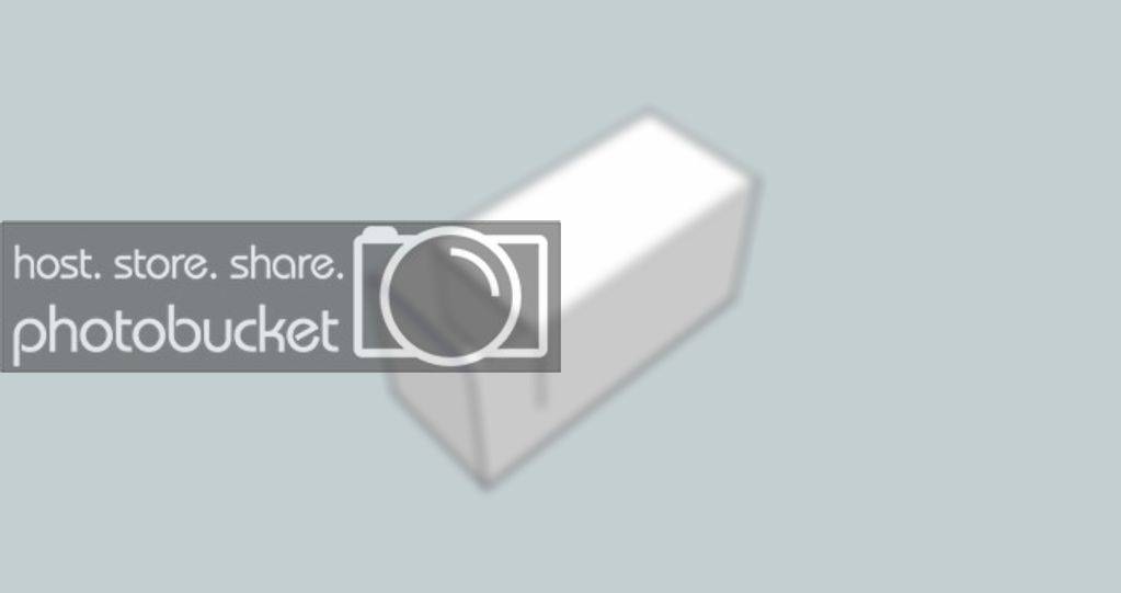

Silverado SS Box for 2 15s ~8 Cubes @ 36Hz
GearGuy2001
OD 48w x 20d x 23.75t
ID comes to around 8 Cubes after Port and 45*s Displacement tuned to 36Hz
8.5" Port gives 157" of Square Port Area

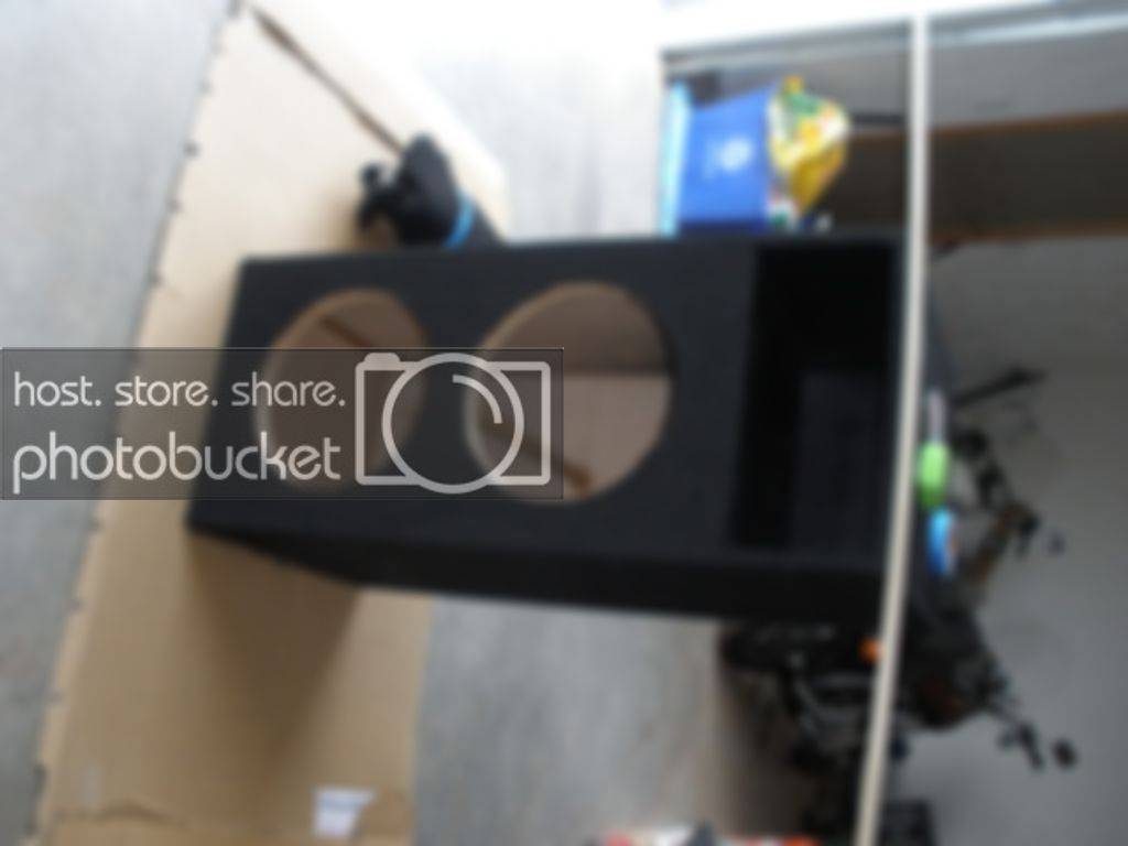

Will be covered in PE Jet Black Carpet
Subs will be Inverted, Cascade Omega 15s and I'm pretty sure off of an Autotek mm4000.1
This is a build for DDBump's Friend

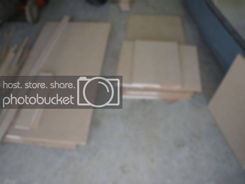

More pictures as they come (I'm going out to cut it now)

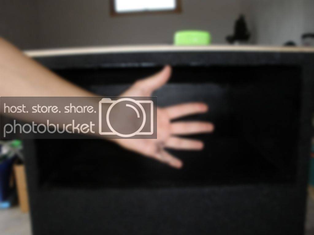

i wouldnt invert them and that box is huge. mine is only 7.3net and they work pretty good in it
Yeah It was not my idea for the size but I think they will handle it fine, I guess we will see //content.invisioncic.com/y282845/emoticons/biggrin.gif.d71a5d36fcbab170f2364c9f2e3946cb.gif

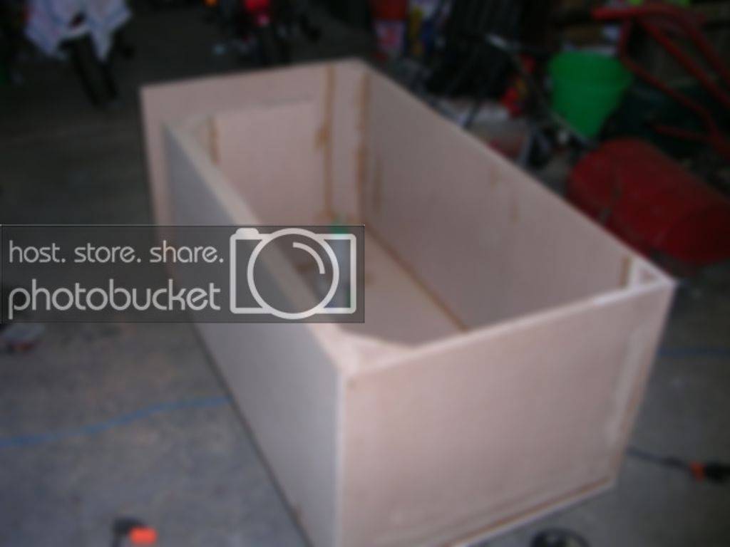

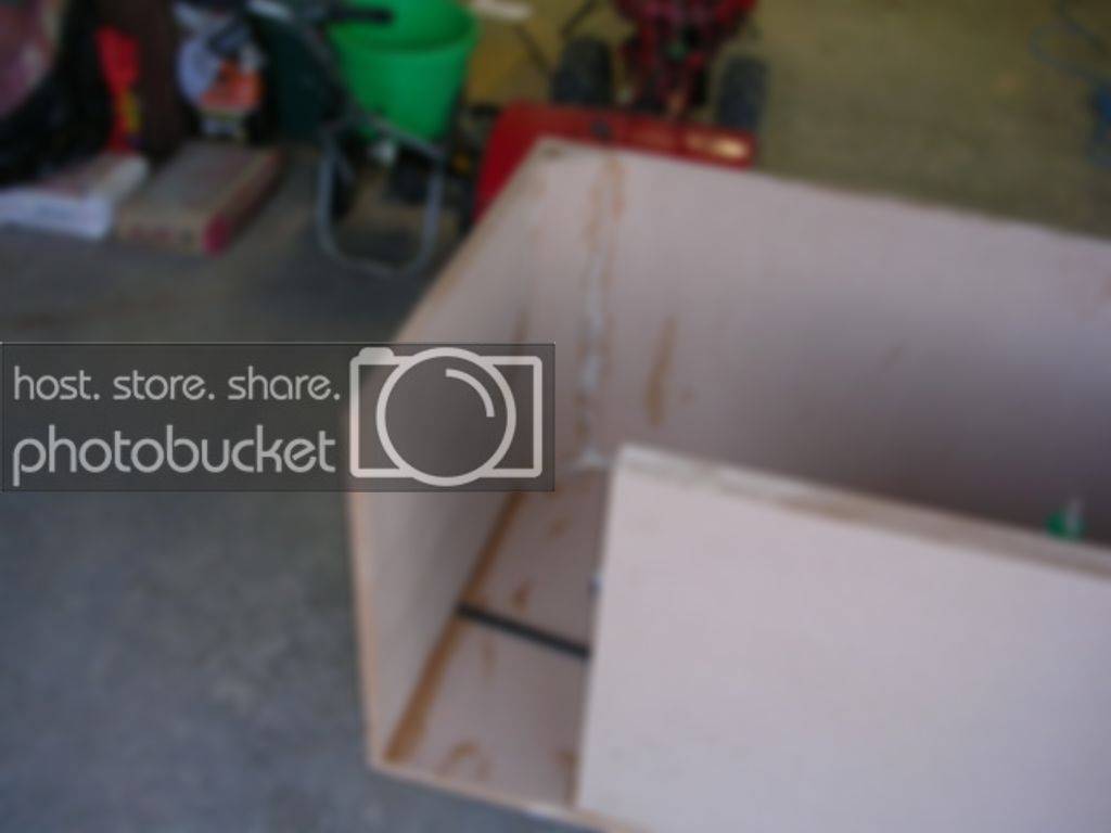

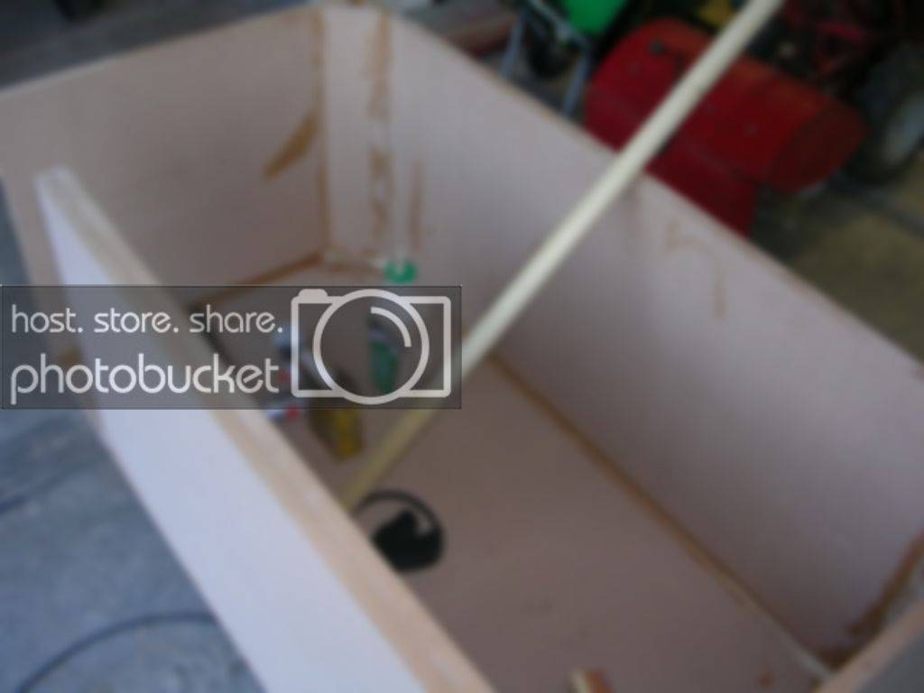

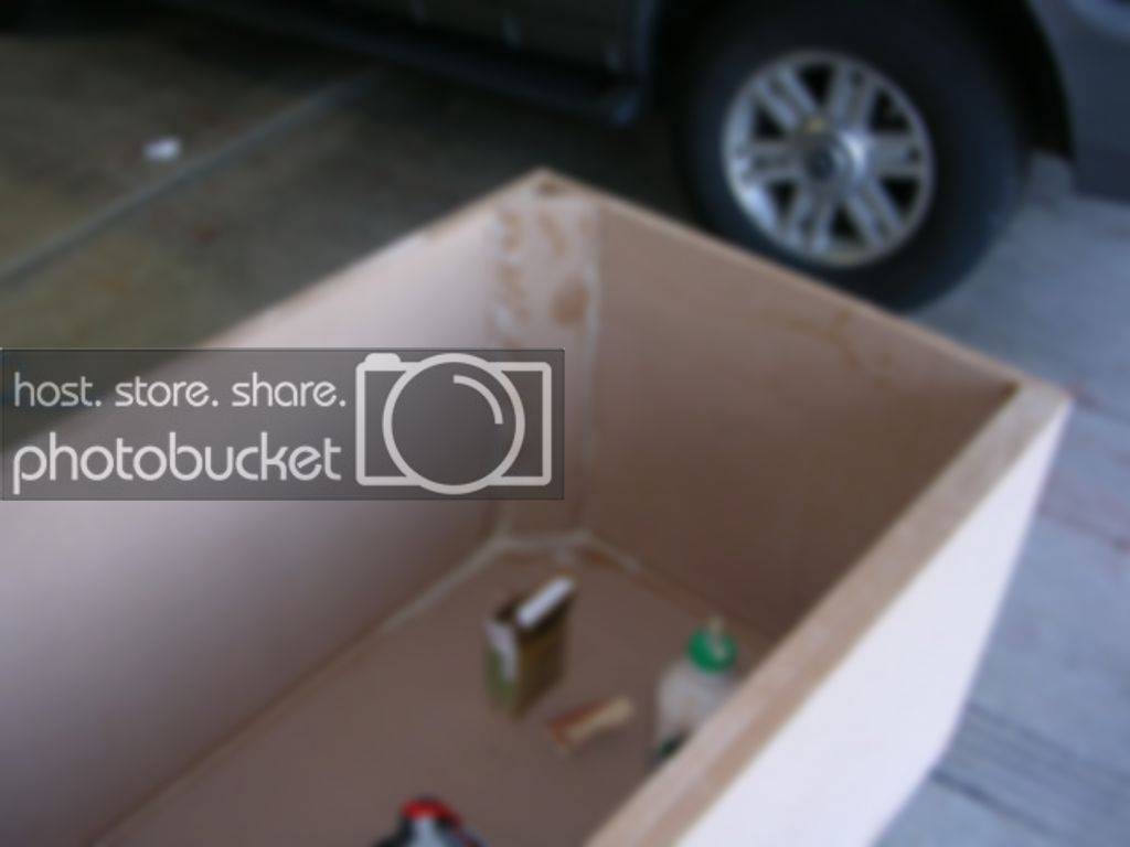

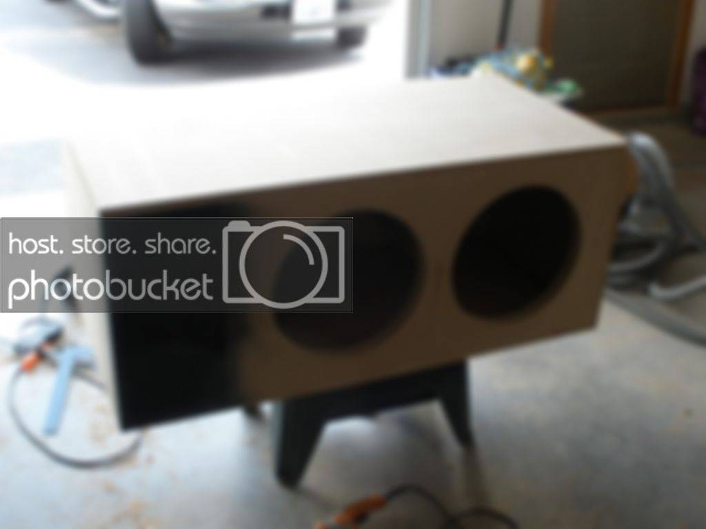

All for tonight, Start assembly tomorrow after work.
yeh mine was supposed to be 8net at 40hz but ended up being like 7.3at 37h lol but i think it might have worked out for the better. they get moving just fine for only a 3k on the pair.
Id rather hit the lows then throw up numbers, I enjoy competing (bassrace) but its about daily music for me //content.invisioncic.com/y282845/emoticons/biggrin.gif.d71a5d36fcbab170f2364c9f2e3946cb.gif
Not sure about this guy but Im guessing @36hz its for daily pounding
