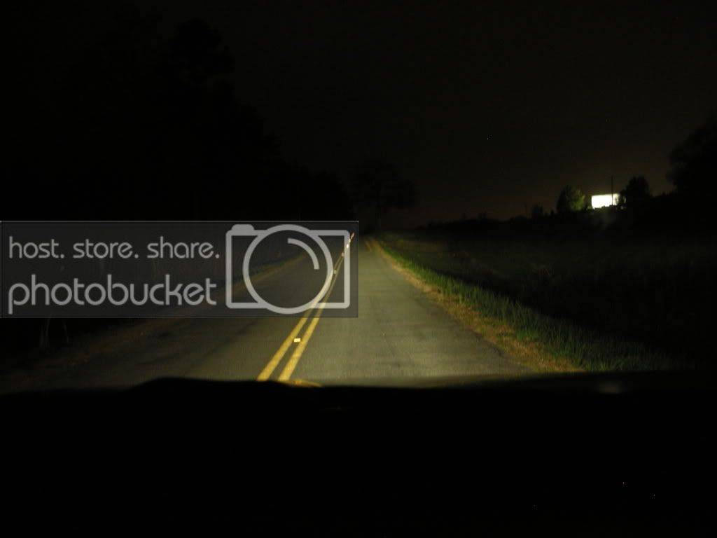

my ultras
Wow. That looks pretty good.
My headlights would only would only barely reach to about the halfway point in between the first and second reflector in your picture.
My moms subaru outback lights extend much further and brighter than mine with the high beams on.
uphill section of road, so it looks a bit shorter, but these are the brights
I actually get flashed all the time. People thinking I have my brights on.(and they are aimed very well as you can see in the pics)
