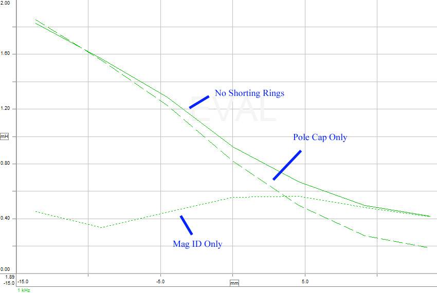

Now... the field can be absorbed by a conductive material in or around the coil -- so shorting rings come into play.
One approach, which we use on the SA series, Z v.3 series, and NS v.2 series, is a pole cap shorting ring -- note how it reduces forward inductance and at rest inductance. But not much in the way of rearward...

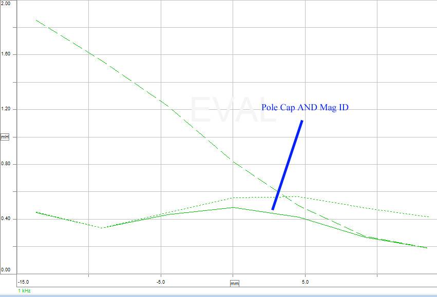

Well the SA Line, the NS v.2/v.3 and Z v.2/v.3 both have a large magnet ID ring -- notice the huge effect on rearward inductance and at-rest inductance ?
Now... having BOTH rings like the SA Line, the NS v.2/v.3 and Z v.3 has a huge effect across the board! Not only is the inductance more linear but it is much much lower.

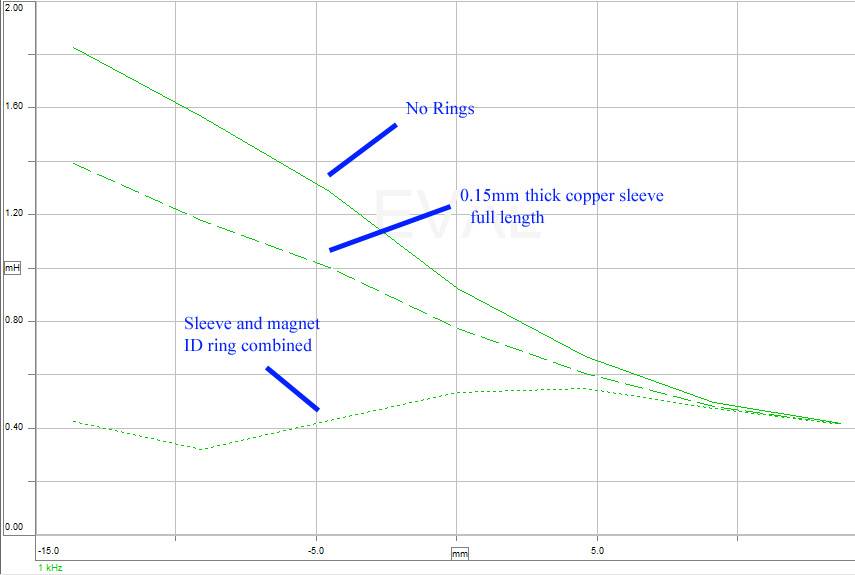

This thin sleeve has a nice effect at rest and on rear-ward -- seems to lose effect combined with the magnet ID ring, though, as that is equal to the magnet ID ring only.

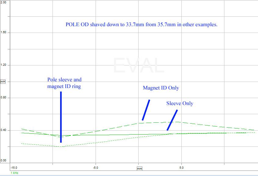

So now lets do a thick sleeve :
Full 1.0mm thick -- and the effect is MUCH better and also alleviates the issue of being cancelled out by the magnet ID ring.
The only problem is you need to add more motor to compensate for this type of sleeve as it widens the gap a good bit -- for this example the pole had to go down from 35.7mm OD to 33.7mm OD to fit this sleeve.
If the design budget allows for this then no problem -- the issue you end up with is spending more money on the motor by adding magnet to it.
The benefit is that the sleeve is the most linear method simulated -- the Le curve is completely flat in this case.
In most cases price to performance the magnet ID ring would be a better selection unless you are going for ultimate reference level.

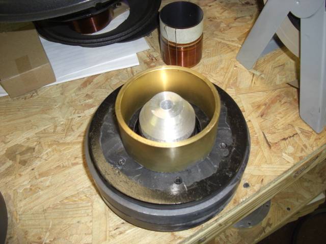

* SA motor -- the top aluminum piece acts as a pole cap ring.
* The brass piece is an example magnet ID ring from a Z v.2 motor. This goes around the inside of the magnets below the top plate / above the back plate.

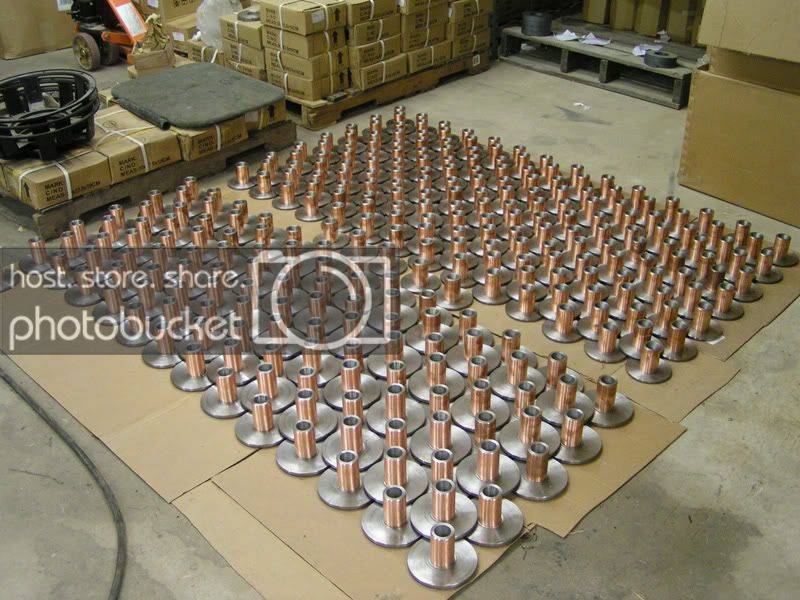

* Acoustic Elegance drivers with pole sleeve shorting rings
