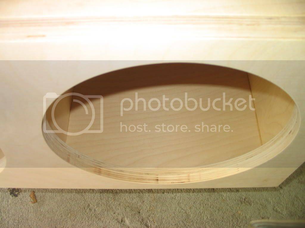

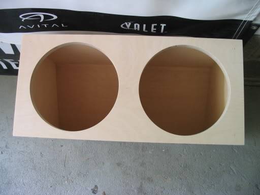

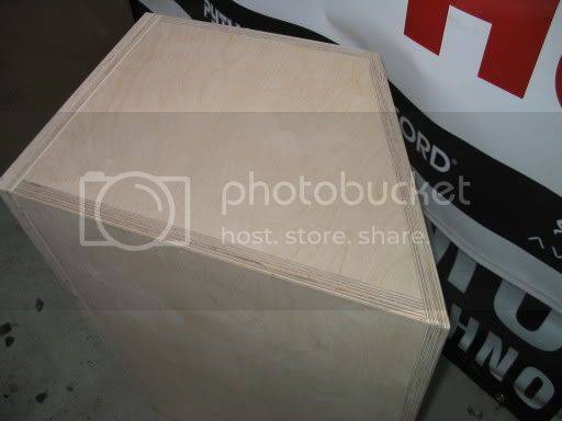

Whats so special about this birch stuff?That stuff just looks like a standard veneer core plywood???
Every other layer is cross hatched for strength, it's normally 9 ply, 1/2in is supposed to be stronger than 3/4in MDF, it's lighter and looks much better than MDF. It also takes a stain very well.
I can get a 5ftx5ftx12MM (1/2in) for $18 and a 5ftx5ftx18MM (3/4in) for $23 locally. It's a little more pricey than MDF but much nicer matial to work w/.
Almost forgot, very nice box by the way.
