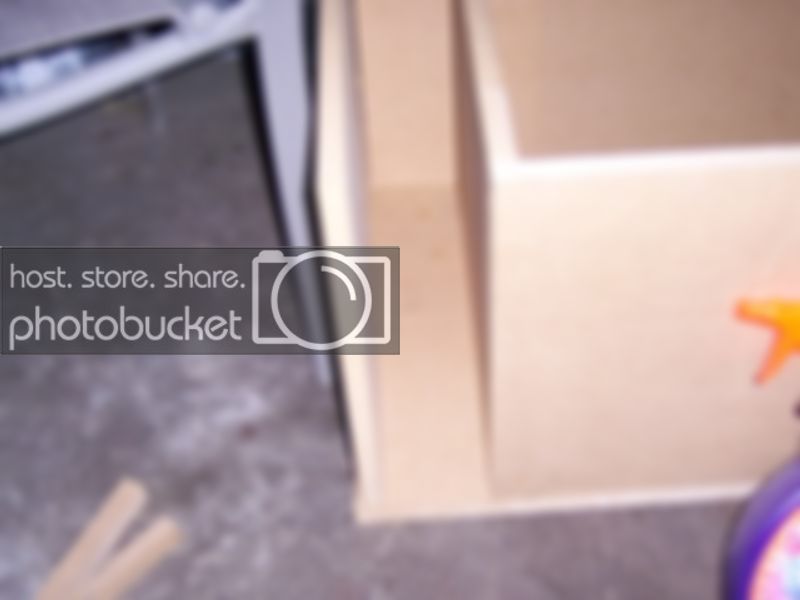

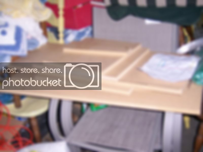

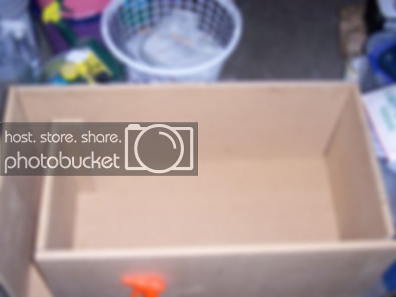

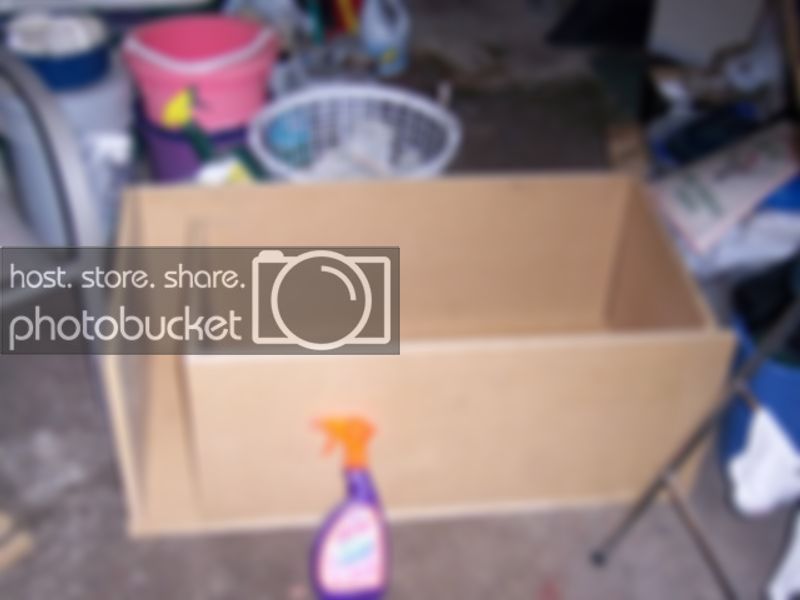

second box i made this week.
blackonblacksls
this box is for a memeber on the board. for two type r's its 4 cubes and tuned to 35 hz.

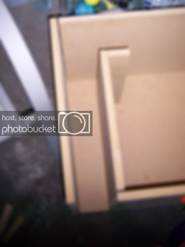

Thats what i always use. Is there something better i should be looking at? And with what and why do you round the port? Does anyone have pictures of this. Is th 45 just for bracing?
I would assume it more for directional purposes to cut down own port noise. with out the 45 the air coming out the port would slam against flat surface and cause turbulence in the corner of the "L". with the 45 there it deflects the air around the turn. but then again i could be wrong.
