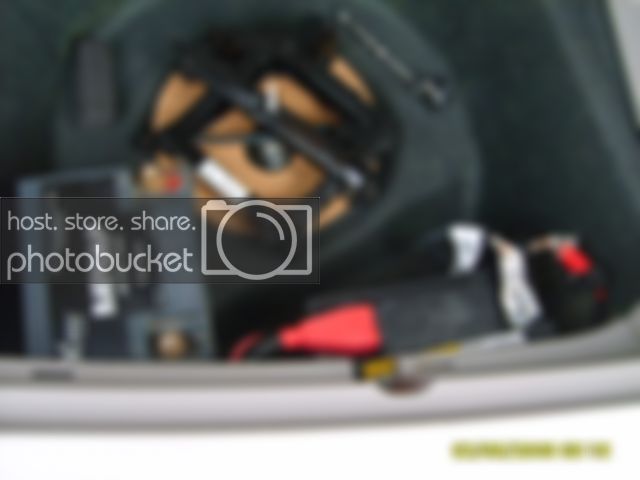

id say kinetik, over the yellow top at least, this little guy is 900 amps 450cca, and is pretty cheap. and it can fit pretty much anywhere you want.
here one i put in earlier. basically the way kinetik rates there batteries is for the second bat an amp for every rms watt you are going to be running.
