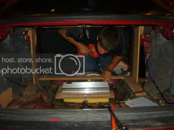

here is what i did in my old bonnivile, i built a frame that was sealed up to the edges for the box to slide into heres from the back
and here you can see the frame wrapped in vinyl and how well it sealed up the the box
before (you can see the wheelwells)
after 3/4" mdf, peeled the carpet back from the metal framing around the opening behind the seats and screwed through it to the MDF. First day i tested i pulled in the garage (it had been raining). got wind sheild flex and the water on the trunk lid didnt even vibrate
