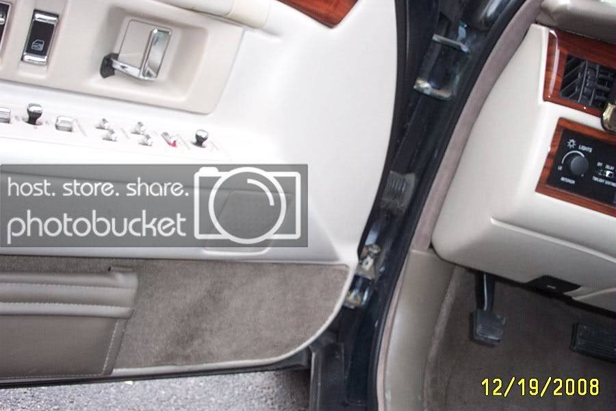

It's an issue of fitting them in my doors. The Kenwoods I have are 5.25" with an 1 1/2" mounting depth, and the new Image Dynamics are 6.5" with a 3" mounting depth... in order to prevent them from hitting the window mechanism I would have to build a 1" baffle/spacer, and on top of that carefully cut away the inside of the trim panel because the speaker would stick out about 1" into the panel. And to make matters worse, the door panel armrest sits about 5 1/2" from the bottom of the door, so the top part of the speaker would be blocked by it.

Here's a pic of what I'm talking about... the darker carpet on the bottom of the door is only 5 1/2" in width and the speaker sits behind it. The smaller grille in the middle of the door is the stock tweeter.
You could build some really nice pods on that door. Nice area below armrest.
Yeah, but I'd have to kinda build them out at a funky angle, and then there's the issue of blending them with the doors //content.invisioncic.com/y282845/emoticons/crap.gif.7f4dd41e3e9b23fbd170a1ee6f65cecc.gif
