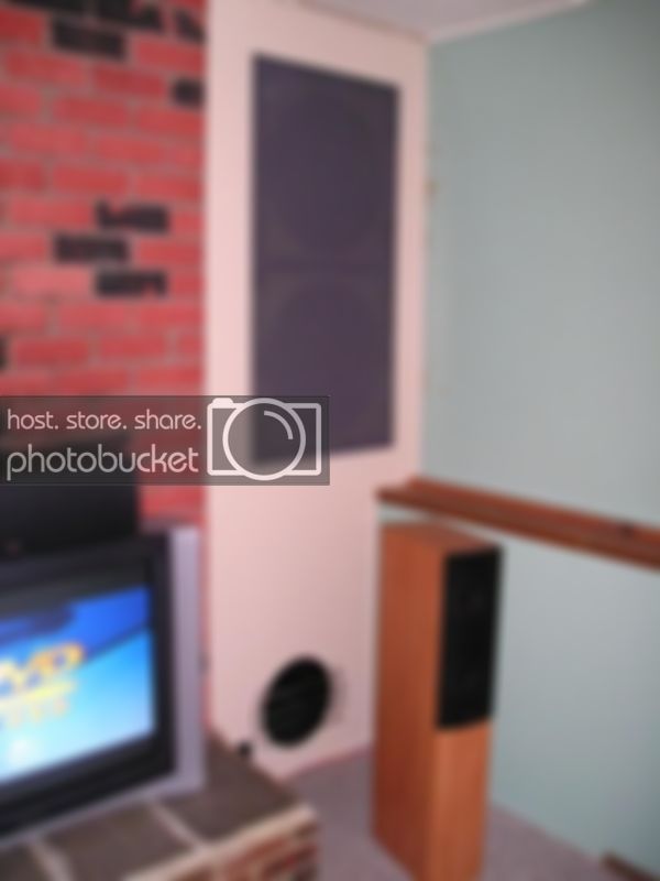

That's our TV system. The PSBs are OK for what they are. The pics were taken ~5 years ago before a remodel.
What drivers did you use for that serious commitment?

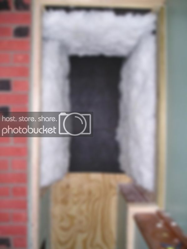

Dayton pro 18". The enclosure is ~46ft3 in a MLTL aliment. It was designed in part by Martin King, who was very kind to help out. We estimate the sub's sensitivity at ~100dB/1w/1m. It's driven by a bridged Samson S1500. The port consists of a 10" sonotube and we can vary its frequency by installing alternate lengths. It was tuned with a BFG using sweeps at 2Hz intervals. I guess it sounds OK. //content.invisioncic.com/y282845/emoticons/wink.gif.608e3ea05f1a9f98611af0861652f8fb.gif
