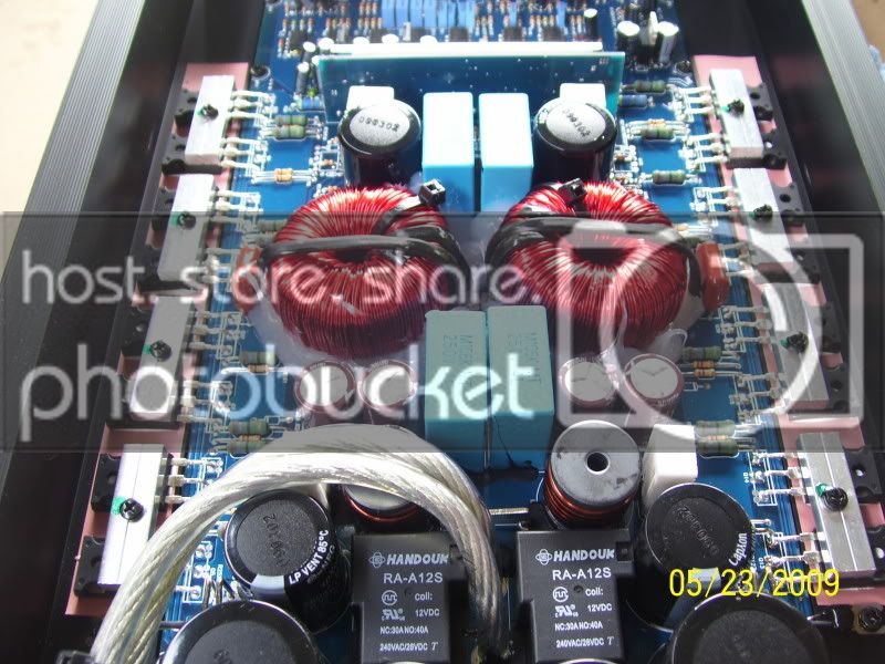

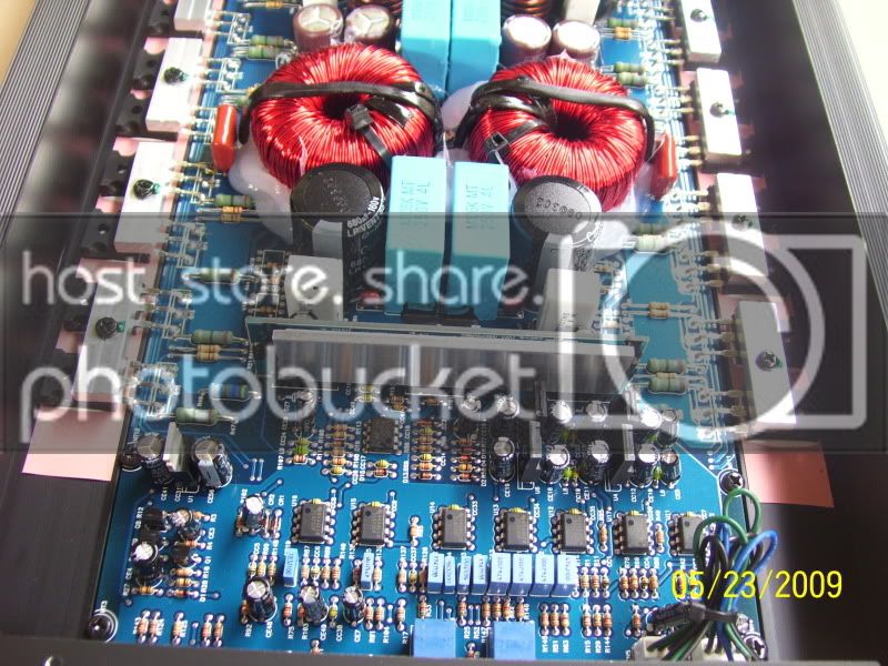

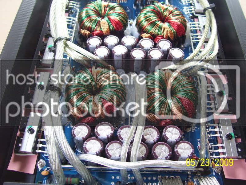

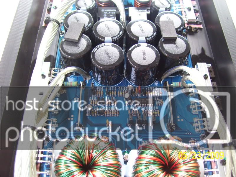

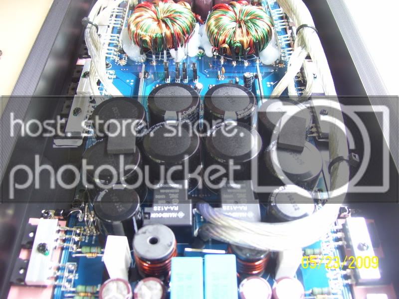

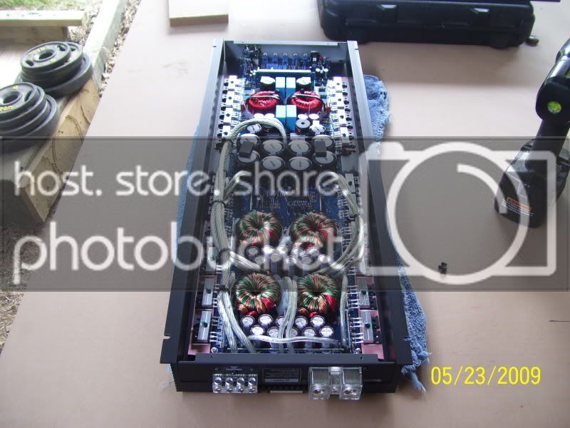

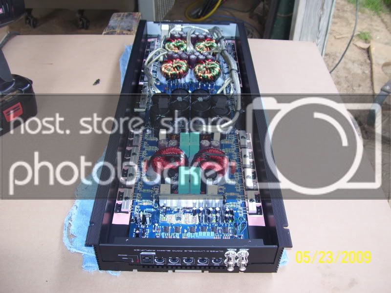

Jacob, Did you spec the wires instead of rails?? I like it.
Yah - I've wanted wires for a while. Most importantly to replace where the transformer leads jumped to other parts of the board (like from the transformers to the rectifiers) - instead the transformers just go into the board and then a wire jumps over.
Over the months / years the transformer leads can vibrate and rub off the enamel and short out at that point.
I have also seen some occasional problems with solder on the larger solid rails.
We took alot of stuff learned on the 3000s over the years and applied it to this model.

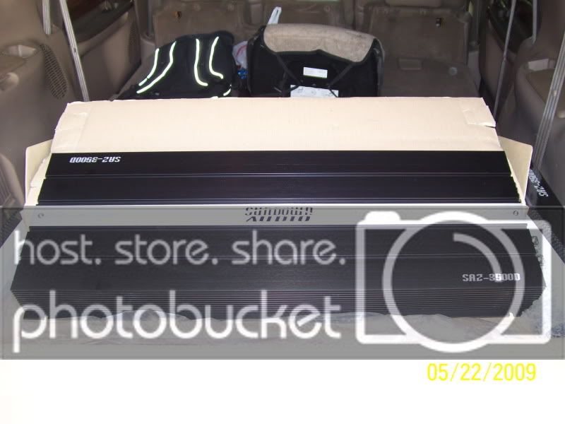

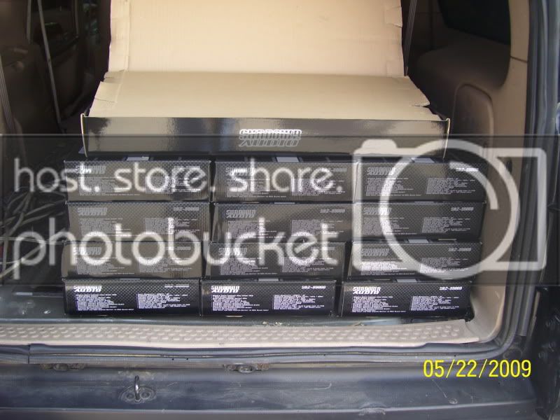

We picked up a few of these yesterday.
More pics later.

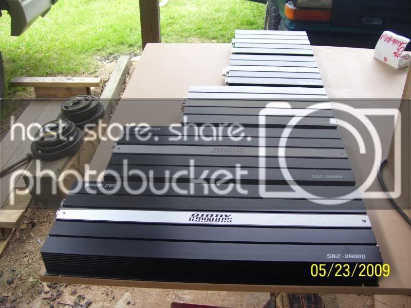

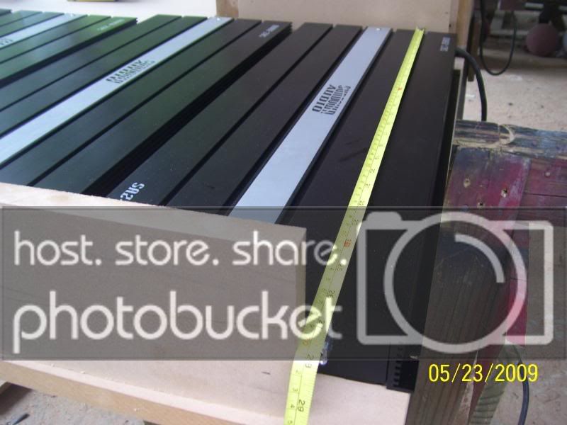

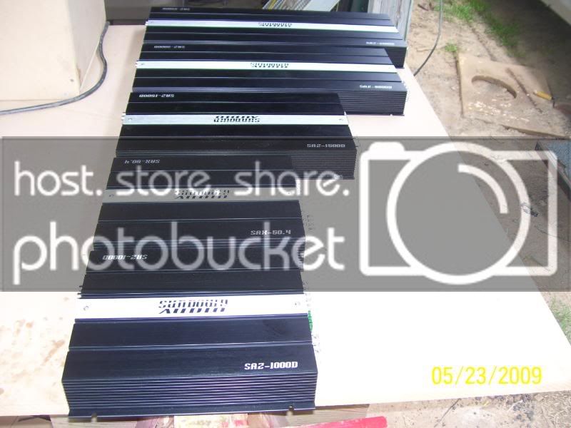

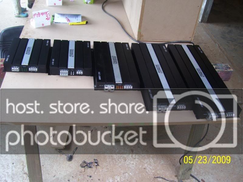

More pics.
From smallest to largest;
saz-3500d, saz-3000d, saz-1500d, sax-50.4, saz-1000d

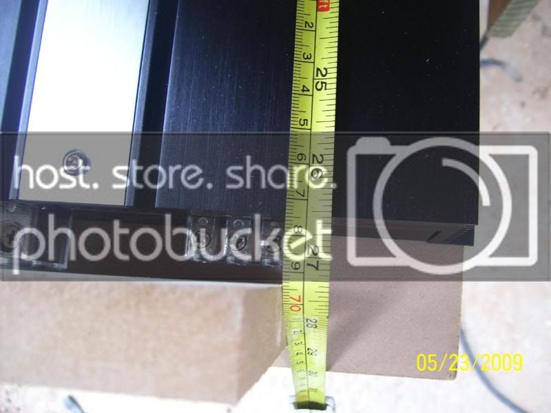

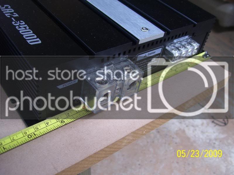

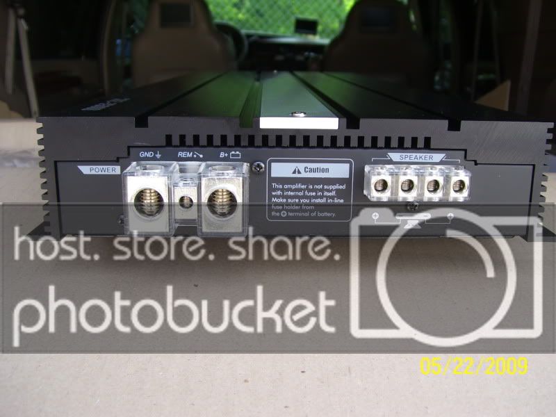

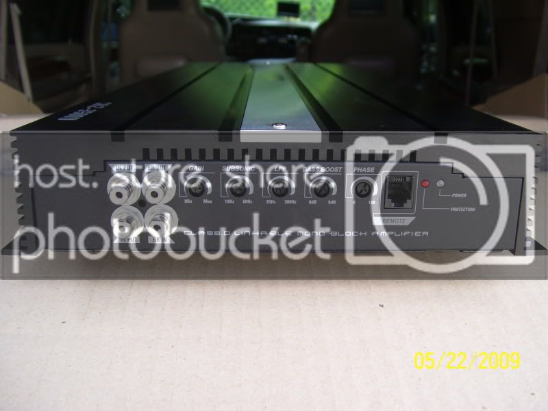

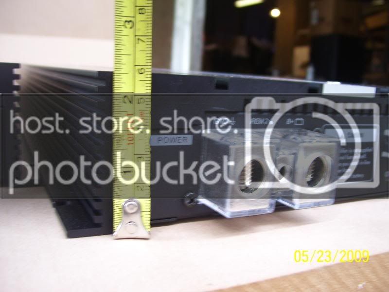

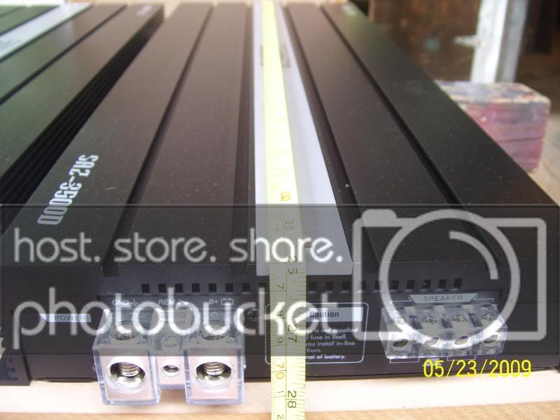

Saz-3500d measurements. Heighth and width are the same as the rest of the saz series amplifiers.
Case is 26" long
Including the rca termninals and power terminals it's 27.25" long.
Width is 10" at the mounting feet.
Heighth is a hair over 2.25"
