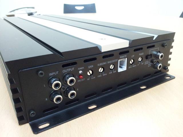

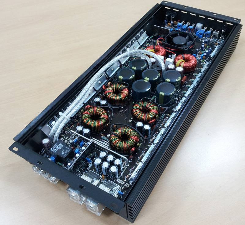

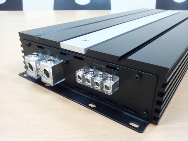

We should have it in a week or so to test ourselves; factory testing has went very well and it is meeting all of our design goals.
Length without feet = 18.89"
With the feet total length is roughly on par with the original version (20.15") -- then the case is of course narrower. So overall foot-print is down.
Will get some side to side pics when the prototype gets here.

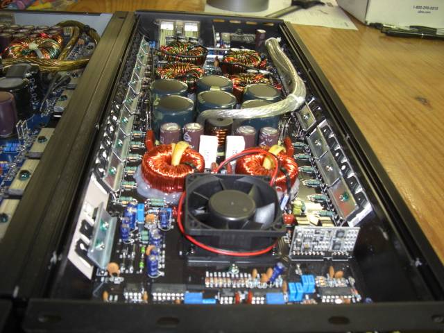

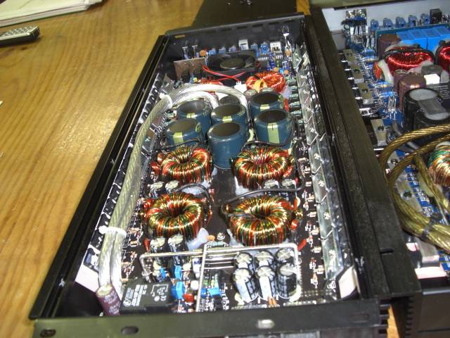

The amp is here at the shop :
* The main capacitor bank now contains 160v units for maximum reliability at 19v operation.
* As with the other new 2012 amps we have a fan
* 16x IRF064N power supply MOSFETs (BEEF)
