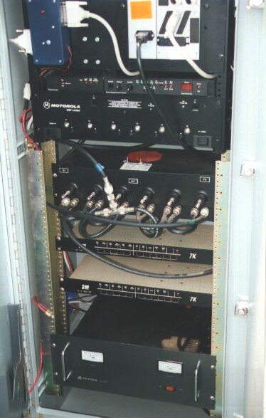

Duplex, think the RF deck is a Motorola now...could be something else though.
Yeah, 440...amateur FM repeaters are from 440-448 with a 5MHz positive offset.

If you have interference problems just throw a tone on it, can help a little if it is opening up the repeater.
Otherwise just get yourself a can and tune it on the receive. If you want one I might have a small rejection filter laying around I could let go for cheap cheap cheap. //content.invisioncic.com/y282845/emoticons/wink.gif.608e3ea05f1a9f98611af0861652f8fb.gif
What size coax and antennas are you running at 1000 ft?
Cavity filters are in the next cabinet. Old pic, but other than a totally rebuilt controller nothing's blown up yet...
Feedline is 3/4" hardline, guess someone just had a bunch laying around and wanted to put it to use //content.invisioncic.com/y282845/emoticons/biggrin.gif.d71a5d36fcbab170f2364c9f2e3946cb.gif Antenna is a stacked collinear vertical...forget how many bays at the moment. So that doesn't help the interference issue at all, either.
There's a PL on the input, but what happens is it'll be a cloudy, rainy Saturday morning and there'll be a nice tropo duct right to that NASA radar and it'll just overload things...and a lot of amateur gear still doesn't do CTCSS/PL decode yet. More are, but not everything...
