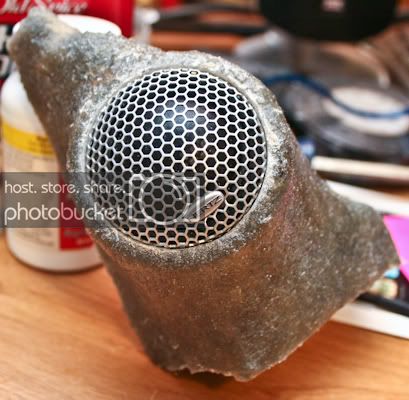

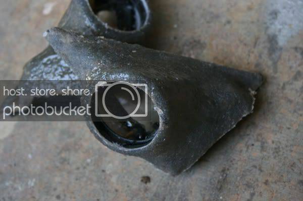

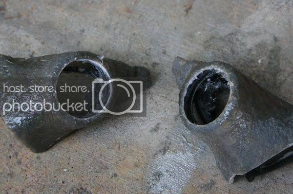

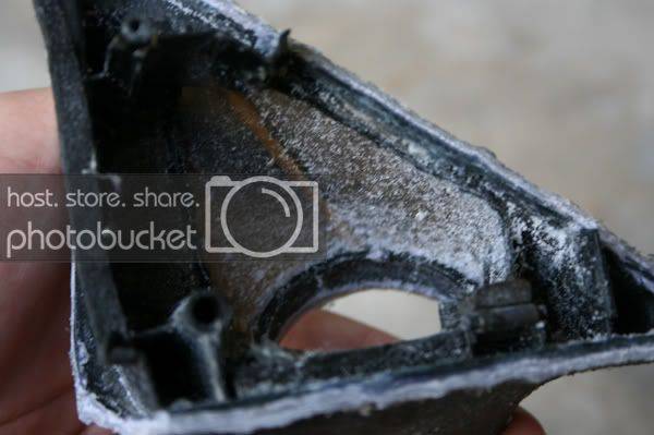

Glad i got back to this post before bondo. Here are the pictures.
They seem to be pretty sturdy. I used thick cloth which seemed to be a mistake but it seems to hold up fine. I could fiberglass it, but i am worried about clearance issues with it fitting in properly as well as it almost hitting the dash.
They are pretty close to being done.

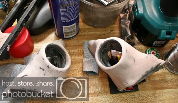

Test Fit
Bondo sanded down
From here i think another thin layer of bondo, and then sand from 80 grit to 150 to 320. Should i go any higher with grit sand paper before putting on primer? Wet sand perhaps?
