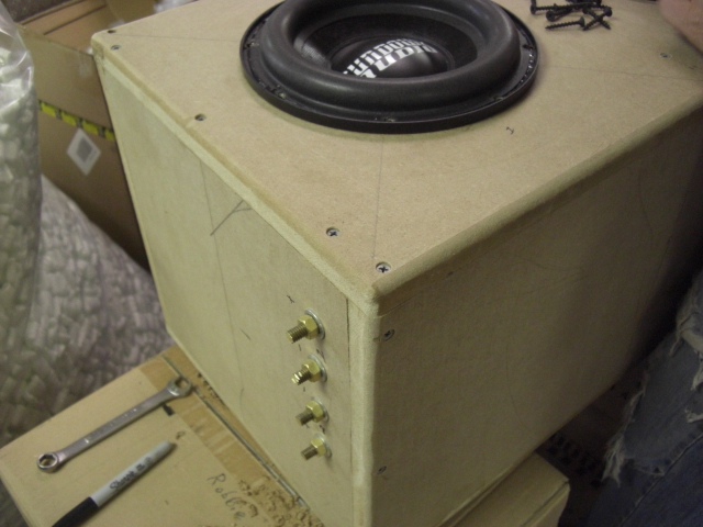

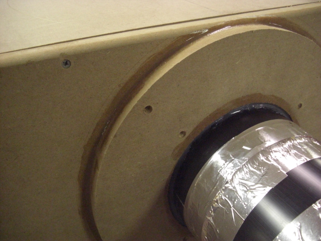

Box Tweaks to be tested :
1) Rounded corners
2) Wires out of port - replaced by brass threaded rod
3) Port carriage siliconed to box and port also siliconed to carriage
4) Duct tape instead of rubber gaskets... the hole cut outs with a bit off so this may help

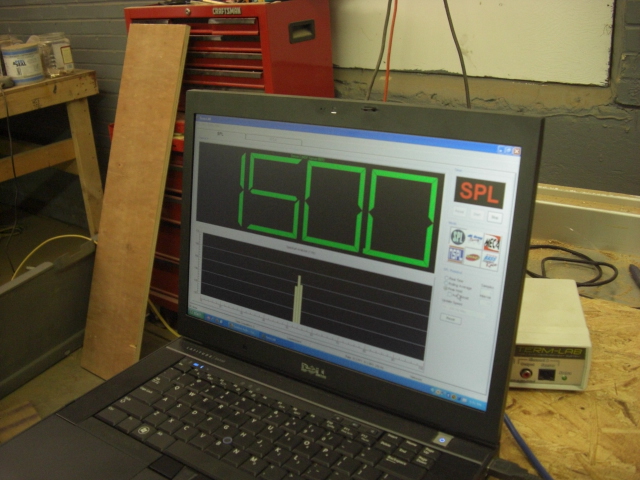

... make that 150.0 with two 8s //content.invisioncic.com/y282845/emoticons/smile.gif.1ebc41e1811405b213edfc4622c41e27.gif
Duct tape FTW + our other improvements (round over, sealed up port, wires through brass rods).
ON TO THE SCORE !
I'll work on actually taking a video shortly and backing the score up... our camera man Derrick wasn't here today to get it the first time //content.invisioncic.com/y282845/emoticons/smile.gif.1ebc41e1811405b213edfc4622c41e27.gif
Yes... this is a sealed on the dash score.
